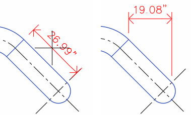

  • The side you ‘approach’ the object from will be the default side of the dimension line.
  • For non-orthogonal objects, an Aligned dimension is the default, so hold down Shift for a Linear dimension.
    Orthogonal and non-orthogonal objects

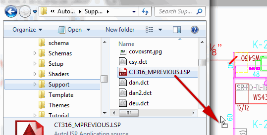

  1. Launch AutoCAD, then open ‘My Computer’ (Windows Explorer) with Windows key + E.
  2. Navigate to where you saved your .LSP, then drag and drop it into the AutoCAD drawing window.
    Loading a LISP with drag and drop
    You will see something like the following response on the command line:
    Command: (LOAD "C:/Program Files/Autodesk/AutoCAD 2016/ Support/CT316_MPREVIOUS.LSP") C:MM
