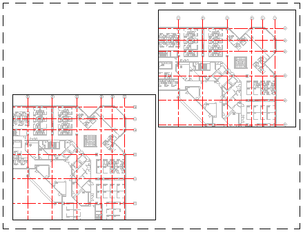

Time for another button on a palette and here's one that will save a few steps. You know how the PSLTSCALE variable needs to be configured by Layout (The Basics, April 2006)? That is one of those things that can get really annoying, especially since you have to run a Regen after establishing the desired value. Once you have set the desired Layout to be active, in the following Command String, you switch to Model Space, set the Psltscale variable, then Regenall, just in case you have more than one viewport to configure.
Layout
First, be sure you have a non-Continuous linetype in Model Space that has an LTSCALE set to a value greater than 1.
Instructions to Automate the Setting of the PSLTSCALE
  1. Open the Tool Palette window, then you will need a blank button to work with (see Odd Spot, April 2007).
  2. Right-click on the blank button, then click Properties to open the Tool Properties dialog box.
  3. Edit the Command String to read as shown below. You can omit the last action of switching back to Paper Space if you want.
^C^CMSPACE;PSLTSCALE;0;REGENALL;PSPACE;

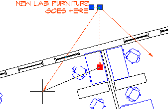

GripsAnyone who has created a Leader using DimensionQuick Leader (QLEADER if you're using A2008), has probably wanted to have more than one leader line to the same text. Yes, AutoCAD 2008 has a Multileader feature (May 2007), but if you still use the Quick Leader command, here's a real simple trick.
Instructions to Create More Than One Leader
  1. Click the leader line to display the grips.
  2. Click the arrowhead grip (it will turn red).
  3. Enter C for the Copy option.
  4. Now click where you want the additional arrowhead.
