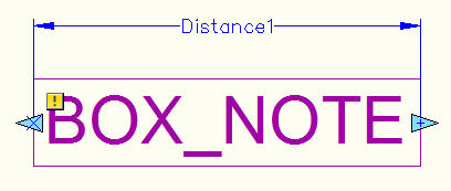

  5. On the Parameters tab of the Block Authoring Palettes, click Linear. Placing a Linear parameter is essentially like picking the two points for, then placing, a dimension.
  6. When prompted to 'Specify the Start Point', use Snap to Midpoint and pick the middle of the left side of the rectangle, then use Snap to Midpoint again, and pick the opposite side, as shown in the figure. Place the location of the Distance label above the rectangle.
  7. Number of Grips
    Click anywhere on the Linear parameter geometry to select it, then open Properties (Ctrl+ 1).
  8. At the bottom of the list of properties for the Linear Parameter, under Misc, set the Number of Grips to 1.

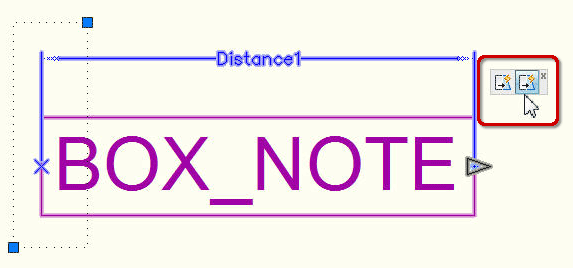

  13. On the Actions tab, click Stretch. When prompted to 'Select Parameter', click the light blue triangle on the right side of the box (the same one as in step 9, above).
  14. When prompted to 'Specify Parameter Point…, press [Enter] for the default of <Second>.
  15. Specify corners
    When prompted to specify the corners of the Stretch frame, specify two corners similar to the dashed box shown figure (around the left side of the rectangle).
  16. When prompted to 'Specify Objects to Stretch', click on the rectangle, then press [Enter].
  17. Click on the small Stretch Action icon that was added after assigning the 2nd Stretch Action. The Distance1 label will highlight and you will see two grips on the dotted box indicating the selection window associated with that action.
  18. Overrides
    Open the Properties window (Ctrl + 1).
  19. Under Overrides, set the Angle Offset to 180.
  20. Close Properties, click Close Block Editor and Save your changes to the block.
Dynamic block in action
Now you can click on the block, then click in the blue Linear parameter grip… and when you move it, both sides stretch!

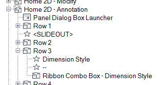

  1. CUI PanelsType CUI to open the Customize User Interface.
  2. Expand Ribbon, then expand Panels, to display the list of all the panels on the Ribbon.
  3. Home 2D
    Expand Home 2D — Annotation, then expand Row 3 to display the content of the panel containing the Dimension-related features.
  4. Click Ribbon Combo Box — Dimension Style to display the content of that node in the Panel Preview area.
  5. Panel Preview

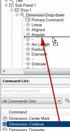

    In the Panel Preview area, click Linear. This will automatically cause the CUI to expand the Dimension Drop-down node under the Panels.
  6. Drag and drop
    Under the Command list, find your preferred dimension routine — I'll be getting Dimension, Continue — then drag and drop it into the Dimension Drop-down list of commands.
  7. When you're finished organizing that listing, click OK to close the CUI and apply your edits.
Drop-down node
Now check out the Dimension drop-down node on the Ribbon to see the result!

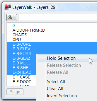

But if you have a long list of layers, it's easy to forget the layers you may have selected already, so use Hold Selection!
How to a Use the 'Hold Selection' Feature in Layer Walk
  1. Open the drawing db_samp.DWG [C:\Program Files\Autodesk\AutoCAD 20xx\Sample\Database Connectivity]
  2. Launch Layer Walk. The layers that are not highlighted (white) are either Off or Frozen.
  3. Select the layers
    Make the dialog box as shallow as possible, then select the layers shown in the figure.
  4. After selecting the layers, right-click, then click Hold Selection. An asterisk will appear beside the selected layers.
  5. Scroll down and select the layers named GRIDLN and GRID-08. To view the content of both layers, you will need to use Ctrl… which brings us to the point.
    When selecting those two additional layers, the original selection set is still displayed. Had you not used the Hold Selection feature, only the GRIDxx layers would be displayed.
  6. Hold the GRIDxx layers, then turn on E-F-STAIR and E-F-COLUMN.
  7. Before you click OK, be sure to clear the checkbox for Restore on Exit.
Hopefully you see where Hold Selection can give you a bit more control over layer visibility and selection when using Layer Walk!
