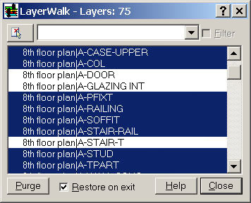

EXPRESS: Layer Walk
We've all had this happen: You open a drawing you have received from an associate/contractor/customer and only a few layers are displayed. Then you open the Layer Properties dialog box to discover there are quite a few more layers in the drawing that are either Off or Frozen.
The Layer Walk utility will display the content of the drawing's layers one at a time, even if the layer is Off or Frozen. It even works on drawings with Xrefs. Very cool.
To see how Layer Walk works, open a drawing, then turn Off and Freeze a few layers. Now take a look at some of the following features:
  1. Click the Layer Walk button to open the dialog box, and then size it to display several layers (In the examples I'm using 8th Floor Furniture.dwg that comes in the Sample folder of A2004 & A2005). Layers that are highlighted in the listing are On in the drawing. Layers that are not highlighted are either Off or Frozen.
Notice the "Restore on Exit" check box at the bottom. If this is checked, when you click Close, AutoCAD will restore the layer state to what it was prior to launching Layer Walk.
  1. To retain the current layer condition (On, Off, Frozen, Thawed, etc.), right-click in the listing and select Save Layer State from the shortcut menu. Enter a name that reflects the current condition. If this is the first time you have seen the drawing, name it ‘Received It Like This' or something similar.
  2. To review the contents of each layer, scroll to the top of the list and click on the first layer listed (possibly Layer 0). Don't panic when all the objects disappear. You can either click on each layer in the list, or use the Down arrow on your keyboard to step thru the listing. Notice when you get to a layer that is Frozen, the Layer Walk routine will display the geometry contained on that layer.
  1. To display only the layers of an Xref, click in the empty edit field at the top of the dialog box and enter the first few letters of the Xref name, then an asterisk, and press <ENTER>. In the sample I'm using, 8th* will suffice. All of the geometry for the Xref is displayed and the listing only displays those layers. At this point you may want to use that Save Layer State feature and name the current layer condition.

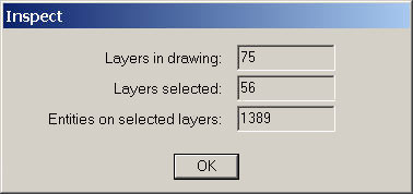

  2. The Inspect item on the shortcut menu shows how many layers are in the drawing, the number of layers selected, and the number of objects on the selected layers.
