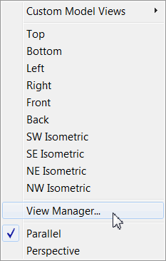

  1. Set the desired view; either 2D or 3D.
  2. Click the middle item of the Viewport Controls, then click View Manager.

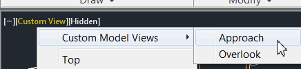

  3. Click New, enter the name of the view, then click OK. You will see ‘Custom View’ displayed in the Viewport Controls.
  4. Click Custom View then hover on Custom Model View to see the list of named views in that drawing!
Select custom model view

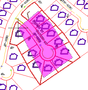

WPolygon and CPolygon—To create a user-defined, closed area for object selection (rather than a rectangular Crossing or Window), enter WP or CP to place points around the objects to be edited in a free form. Since these features create a closed area, you will essentially be placing points for a ‘rubberbanding’ enclosure.
Use WPolygon to select only those objects that fall completely within the bounding area of your shape.
Use the CPolygon feature to select all objects within, as well as those crossed by, the crossing lines of the shape (as shown in the illustration using AutoCAD 2014).

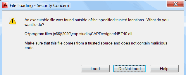

With most new computers, you may need to configure Windows to allow you ‘Administrative privileges’, but this ‘Security Concern’ was a new one to me.
Security Concern
As it turns out, if you have external routines that are loaded via the Startup Suite or a 3rd party application, you will want to add their path to Trusted Locations.

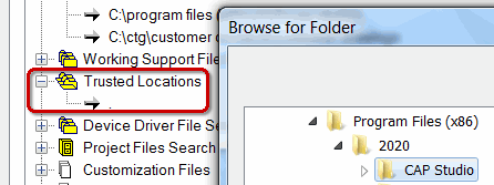

  1. Trusted LocationsGo into Options.
  2. Expand Support File Search Path.
  3. Click on Trusted Locations.
  4. Click the button for Add, then Browse to open the Browse for Folder dialog box.
  5. Navigate to and select the folder containing the program ‘outside of the trusted locations’, then click OK. In this example, I'm specifying the folder for my CAP Designer software (from 20-20 Technologies, Inc.).
From that point forward, you shouldn't get the ‘Security Concern’ dialog box!

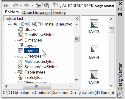

  1. To open DesignCenter, you can either use Ctrl + 3, or go to the View tabPalettes panelDesignCenter.
  2. Navigate to the drawing containing the layout tab you would like to add to the current drawing.
  3. Expand the drawing node by clicking the plus sign (+) to display the available content from that drawing which can be brought into the current drawing.
  4. Click on the Layouts node to display the layouts contained in that drawing.
    Layouts
  5. Double-click the name of the layout to add, or click and drag it into the drawing area!
Note: Only contents of the layout tab will come into the current drawing, nothing from Model Space.
