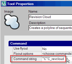

  1. Right-click on the Revision Cloud button on the palette, then click Properties to open the Tool Properties dialog box.
Revcloud command string
Here's what the Revcloud's Command String means:
^C^C - Cancel; essentially hits the ESC key
_revcloud - The underscore in front of the command means to use the English version of the command. You can delete it.
space - You will also notice there's a space after the command; you can back that out, too. (See the semi-colon comment below.)
  1. Edit the Command String to read as follows (it is not case sensitive; I did that so you could see it better):
^C^CREVCLOUD;A;30;90;S;C

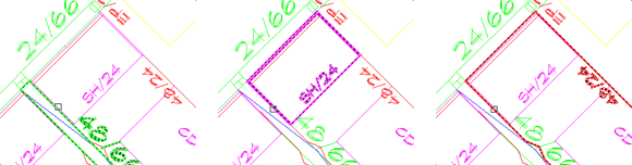

It's been awhile since I covered this [specifically, about four years - December 2003], but prior to AutoCAD 2007, to cycle between objects that were essentially stacked on each other, you held down the Ctrl key, then clicked to cycle between those objects. Beginning in A2007, there was a bit of a change.
For those of you with A2007 and beyond, if you have objects that are stacked (i.e., the edge of the reflected ceiling plan layer is also where the wall line is, which is also where the carpet line is, etc.), here's what you need to do to select objects that essentially occupy the same X,Y location.
Instructions to Cycle Through Stacked Objects in A2007+
Selection Preview
  1. Launch the desired edit command (this only works with editing commands - such as Move, Erase, etc. - where a pickbox is enabled).
  2. Place your pickbox over the location where you suspect more than one object and if the Selection Preview feature is enabled (ToolsOptions… Selection tab), one of the objects under the pickbox will highlight… and, of course, it won't be the one you want to edit…
  3. [Here's where it gets interesting] Hold the Shift key down and tap the Spacebar and AutoCAD will cycle between the objects that are under the pickbox. Seriously.
Object cycling
…which is not totally unlike rubbing your belly and patting your head while jumping on one leg.
