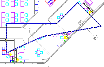

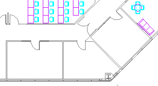

A Wipeout object is a glorified 3D face; a 2D solid. Curiously, when you select a wipeout object and open the Properties window, it's listed as a Raster image (the reason will be forthcoming). The Wipeout command used to be in the Express Tools, but beginning with A2005, they moved it (more like buried it) to the Draw menu. It has no presence on the Draw toolbar, just in the menu. To see the power of this feature, I'm going to open the A2004/A2005 Sample drawing called 8th Floor Furniture. It is a furniture drawing containing an Xref as the base plan.
Instructions to Create a Wipeout Object
  1. Create a polyline (on the desired layer) around what you want to "cover" with the wipeout object. You will need to use the Close option of the Pline command for the wipeout to work.
  2. Launch the Wipeout routine, then press [Enter] to accept the <Polyline> option.
  3. Select the existing polyline.
  4. When prompted to "Erase polyline?", enter Y (the wipeout object has its own Frame).
  5. Don't panic. You have effectively converted the polyline to an opaque wipeout object "covering" the objects.

Select objects below the wipeout - With no command current, window the area where the wipeout has been created. You will see the objects (along with the grips) covered by the wipeout.
Adjust the wipeout shape with grips - Turn on the wipeout frame, then click the wipeout frame to display the grips. Take a grip and reposition it to another location. Move the entire wipeout to another area of the drawing to get the feel for how the wipeout works.

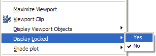

Instructions to Lock the Viewport Display
  1. While in the Layout, single click on the viewport frame, then right-click and go to Display Locked, then slide over and click Yes.

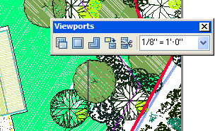

  2. To prove that indeed the display is locked, double-click inside the viewport to make it current.
  3. You will notice that the plot scale of the viewport shown in the Viewports toolbar dropdown list is grayed out. That's your first indication that the viewport is locked.
  4. Use your wheel mouse or the Pan or Zoom commands. You will notice that the entire layout may pan or zoom, but not the display of the objects as they relate to the viewport.
