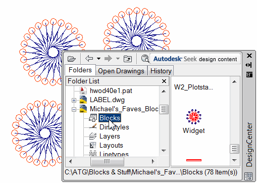

  1. Open the drawing containing Widget blocks which display the old definition. In the figure, you see three instances (references) of the Widget block.
  2. Open Design Center (Ctrl + 2) or Insert tabContent panelDesign Center.
    Note: The Basics section of Michael's Corner from June-October 2005 covered various components of Design Center.
  3. In Design Center, on the left had side where you see the folders, navigate to the Source file for your tool palette blocks.
    Design Center
  4. Expand the drawing node, then click the Blocks node to display the blocks in that drawing (amongst which is my Widget block for this scenario… with a new definition).
  5. Refine onlyIn Design Center, right-click on the Widget block to display the shortcut menu shown here.
  6. Click Redefine only and all the Widget blocks in your drawing are updated!

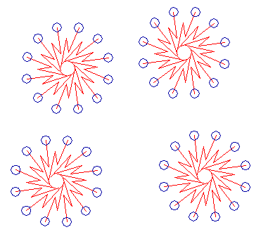

Result

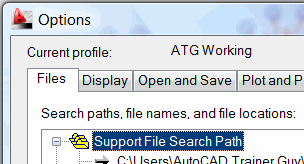

Support File Search PathIt took a question from a reader to push me into learning how to do this and I'm not sure why I waited so long. There are hundreds of free hatch patterns available online. In your quest to find hatch patterns, you're looking for .PAT files (the ones I found for my customer were from www.autocadhatch.com).
Note: You will want to make sure the folder to which you save your hatch pattern (.PAT) is on the Support File Search Path (OptionsFiles tab).

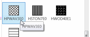

  1. Launch the Hatch commandAfter downloading and saving the .PAT file, launch the Hatch command.
  2. On the Hatch tab, click Hatch Pattern to display the graphic list of available hatch pattern swatches.
  3. If your .PAT file is in a folder that's on the Support File Search Path, you will see your downloaded pattern in the list (probably at the bottom).
  4. Click on your hatch pattern and place the hatch as desired.
Completed hatch

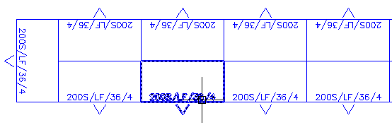

Annotative textIn June 2007 I covered the new-to-A2008 Annotative text feature (page 110 in The AutoCAD Workbench). And although I understand the concept and can hammer my way through it, I've never become a fan. It can be very confusing since it actually creates additional text objects that you may encounter if you click on annotative text (shown here).
My typical response to the emails I get is to simply set the Annotative property for all text objects to 'No'… but what if the annotative text object is in a block?
Illustration 1
In this first illustration set, the Annotation Visibility is toggled off so it shows annotative objects for the current scale only.
Illustration 2
In the second illustration set, the Annotation Visibility button is toggled on to show annotative objects for all scales.
Bottom line: Don't get too bogged down in the annotative logic - or apparent lack thereof - just remember, if you can't see text that you know is there, check the setting of the Annotative Visibility button.

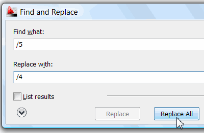

FindOn the Annotate tab of the Ribbon is this wonderful little tool called Find (curiously, there's no tooltip).
Let's say you have several attributed blocks in a drawing, and you discover that the attribute value needs to be changed… for all of the blocks with that value.
Find and ReplaceClick Find to open the Find and Replace dialog box (that is virtually identical to the one you find in other Windows applications).
Enter the desired ‘Find’ and ‘Replace’ values, then click Replace All!
Result
