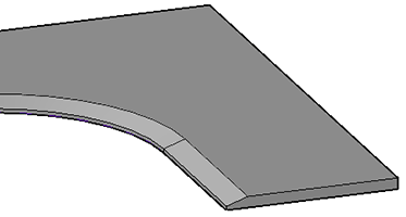

Solid object with a chamfer

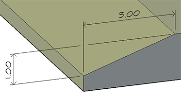

A Chamfer, however, has two Distance values that are applied—Distance 1 and Distance 2—and the sequence is important when selecting the surface for each distance.
Chamfer dimensions

  3. In this example, I'm setting the ‘first chamfer distance’ to 3″.
  4. The ‘second chamfer distance’ will be 1″ in this example.

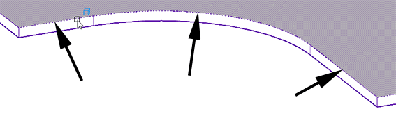

    Selecting faces
  6. Press [Enter] for the OK option when the desired surface is highlighted. That is considered the ‘base surface’.

  9. The next prompt—Select an edge, or [Loop]—is prompting you to pick the lines defining the edge(s) where the chamfer will be applied. In this example, I selected the three top edges of the front surfaces of the solid as indicated in the illustration.
  10. Press [Enter] after selecting the edges and your chamfer is applied!

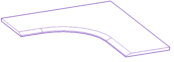

    The completed chamfer

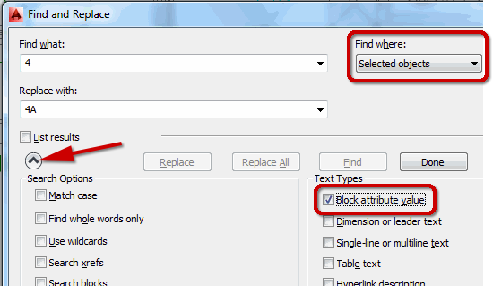

    Find dialog
  2. Enter the value for Find what and your Replace with text.
  3. Now, click the More Options button on the bottom right to display the available search options.
  4. Clear all the check boxes except in the Block Attribute Value (or whatever text type you're finding), then click Replace All.
Note: You may want to specify a refined area of the search by changing the Find Where area in the upper right corner.

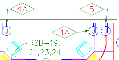

Example drawing
In the illustration, notice the attributes displaying 4A have been changed, but not the Mtext object containing the string ‘…23,24’.
