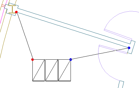

The Align command is buried in the 3D Operation section of the Modify menu so not a lot of people even know it's out there. It's a very intuitive procedure that accomplishes a Move + Rotate based upon two sets of points.
Instructions to Align Selected Objects
  1. Begin the Align command [AL] and select the objects, then press ENTER.
Note: There is no button for this command so you'll have to make your own if you want one.
  1. Pick the first source point on the selected objects. This point will be physically moved to the first destination point.
  1. Pick the first destination point which will effectively be the "anchor point". Each of these points are indicated with the red dots in the figure.
  2. Pick the second source point on the selected objects. This point will be essentially "aimed toward" the second destination point (the blue dots in the figure).
  1. Pick the second destination point. The second pair of points are indicated with the blue dots.
  2. When prompted for the third source point, press ENTER to continue on to the next prompt.
  3. Since most of you will be using this for a Rotate/Move, press ENTER (for NO) when prompted to scale objects based on alignment points.
AutoCAD will then whip the selected objects up against the vector defined by the first and second destination points.
