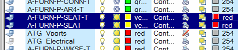

Instructions to Specify Viewport-Specific Color Overrides
  1. Set a viewport to be current, then open the Layer Properties Manager and you will see several columns that are Viewport-specific.
  2. Select all the layers (right-click, then click Select All).
  3. In the VP Color column, click a color swatch, then click the color you want for all the layers in that viewport. Click OK to close the Select Color dialog box.
  4. In the layer list, select the layer(s) you want to emphasize in that viewport. In this example, I'll emphasize the seating.
Select Layers
  1. In the VP Color column for the layers you selected in Step 4, click the color swatch and select a color to emphasize the objects on that layer, then click OK to assign that color to the selected layers.
Viewport
  1. Click OK to close the Layer Properties Manager and in the current viewport, you will see the color assignments you made for those layers!
Q: If you decide against the assignment of an override in a viewport, how do you turn it off?
A: Select the layers for which you want to turn off the override, then right-click and click Remove Viewport Overrides ForSelected LayersIn Current Viewport Only (or In All Viewports).

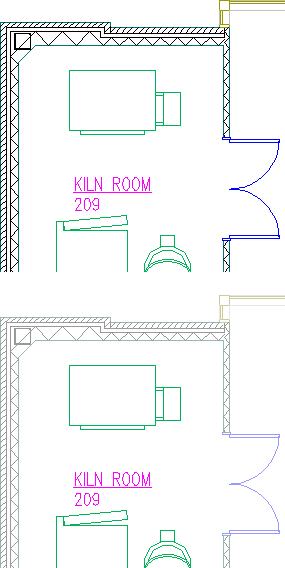

Layer IsolateThe Layer Isolate feature has been around since at least the Bonus collection back in R14. In AutoCAD 2008 they kick it up a notch by adding a Settings feature whereby you can opt to either turn Off the layers you don't select to isolate, or Lock them… which kicks in the new A2008 Fade control feature.
FadeHere's the new prompt sequence with a running commentary…
Command: LAYISO
Current setting: Hide layers, Viewports=Off
In the past, any layer not selected to isolate was, by default, turned Off.
Select objects on the layer(s) to be isolated or [Settings]: S
Enter S to launch Settings.
Enter setting for layers not isolated [Off/Lock and fade] <Off>: L
You now have the option of Lock and fade; enter L for that option.
Enter fade value (0-90) <60>: [Enter]
The default of the fade percentage is 60% which should be just fine.
Lock iconIn the figures, the furniture and text were selected to isolate, resulting in the building features to be faded. A lock icon indicates the locked layer when the cursor rolls across a locked layer.
