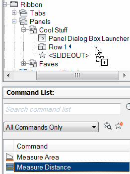

  1. New PanelUnder the Ribbon node, right-click on Panels, then click New Panel and enter a name. In this exercise, my panel name is Cool Stuff.
    Note: Under your panel name, you will see three default components: Panel Dialog Box Launcher, Row 1, and <SLIDEOUT>. In the next step, you will put commands in Row 1 for this panel.
  2. Drag commands to Row 1Similar to adding commands to a toolbar (see December 2008 & January 2006), from the Command List, drag and drop your favorite command(s) up and release it next to Row 1.
  3. Then, after populating Row 1 with commands, drag your "Cool Stuff" panel up, and drop it beside your tab.
    Drag panel and drop beside tab

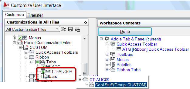

  1. To have your new tab (with the associated panel) recognized in your workspace, go back up to the Workspaces node and click the name of the workspace where you want this tab & panel to (mine is current). You will now see the Workspace Contents area in the upper right quadrant of the CUI.
  2. Customize WorkspaceUnder Workspace Contents, click Customize Workspace.
  3. Under CUSTOM (where you made your tab and panel), put a check in the box beside your newly created Tab. You will now see your new tab Ribbon Tabs listing of your Workspace Contents.
    Ribbon Tabs listing
  4. Click Done, then click OK to apply and close the CUI, then check out your new tab!
Cool Stuff PanelNote: If you want to add more commands to your panel, just open the CUI, go to CUSTOM and expand your Panel, then drag and drop commands onto Row 1. When you apply the changes and close the CUI, your panel will be updated with the additional commands!

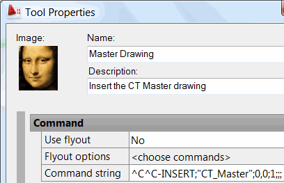

  3. Open the Tool Palette window, then you will need a blank button to work with (see Michael's Corner Odd Spot, April 2007).
  4. Right-click on the blank button, then click Properties.
  5. Edit the Command String field to read as follows:
    ^C^C-INSERT;"CT_Master";0,0;1;;;
    To suppress the dialog box and issue the command line version of a command, you can place a hyphen in front of the command; in this case –INSERT. The following are the prompts you will see along with the responses you have in the macro.
    Enter block name or [?]: "CT_Master"
    Specify insertion point or [Basepoint/Scale/X/Y/Z/Rotate]: 0,0
    Enter X scale factor, specify opposite corner, or [Corner/XYZ] <1>: 1
    Enter Y scale factor <use X scale factor>: [Enter]
    Specify rotation angle <0>: [Enter]
    Tool Properties
  6. Enter a Name and a Description (optional) for this tool, then click OK. Ah, and if you right-click on the empty image location, click Specify Image and go find one of five different raster image file types.
  7. To test it, open any drawing that doesn't have the layers, etc. from the master drawing, then click the button… then check the layer list!

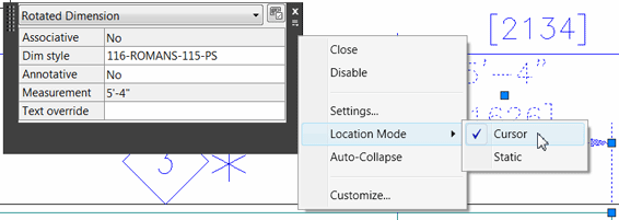

  1. OptionsOn the Status bar, click QP to enable the Quick Properties feature.
  2. Select an object in the drawing. In this example I clicked on a dimension.
  3. In the upper right corner click the small Options icon to display the shortcut menu.
  4. The default Location Mode of Cursor is very convenient, but I would suggest you turn off the Auto-Collapse mode; it just seems counter-productive for a feature that's "Quick".
    Location Mode - Cursor
    Click and DragNote: The Quick Properties window can be moved by clicking and dragging from either of the side borders (curiously, not from the bottom border).
  5. Press Esc, then click on another object in the drawing to display the quick properties exclusively for that object. If you select more than one object while in the Quick Properties, similar to the Properties window, the word "All" will be displayed and the selected objects will be available from the drop-down list.
