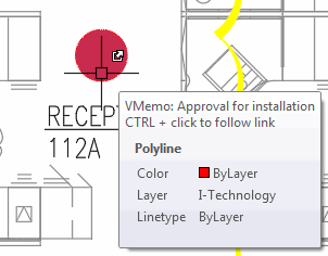

  1. Create an object — such as a Donut — on a separate layer for your hyperlink.
  2. On the Insert tabData panel, click Hyperlink, then select the object.
  3. Brows for FileIn the Insert Hyperlink dialog box, under Browse for, click File, then navigate to and select the file to open/launch when you initiate the hyperlink.
  4. Change the Text to Display to something less cryptic.
    Text to display
  5. Click OK, then Ctrl + Click on the object to check out your hyperlink!
    Check the link
Note: When linking an audio file, the audio loops in its application window, so you may need to cancel it.

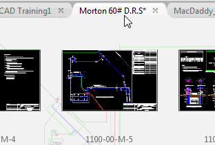

As you may have discovered, when you pause over the File tabs of an open drawings, you see a preview of the layouts of that drawing.
Without preview
One of my power users in Los Angeles (at Associates Purchasing), was wondering if you could suppress the preview.
Solution: FILETABPREVIEW > 0
Preview
With the variable FILETABPREVIEW set to 0, you get a list of the layout tabs when you pause on the File tab. You will see more tabs using this setting, too, just in case a preview wasn't necessary.
