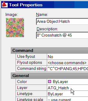

  1. In the Command String box, enter the following (or just copy this string):
^C^CHPNAME;"USER";HPSPACE;8;HPANG;45;HPDOUBLE;1;HPSEPARATE;1;-HATCH;S;\;;
Tool Properties
You will notice that -HATCH is used to issue the command line version of the Hatch command. The remaining characters and their function are:
S Issues the Select Objects option of the Hatch command
; Use a semi-colon to press Enter
\ Backslash pauses for user response
To complete your button, I would recommend you set the desired Layer, Color, and Linetype.
To put a picture on your button, right-click on the blank image box in the upper left corner of the Tool Properties dialog box and click Specify Image. Navigate to any location where you have a BMP, JPG, PNG, GIF or TIF file that you would like to use as the button image.

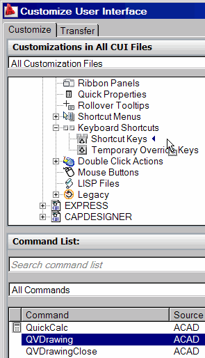

  2. Open the CUI dialog box by typing CUI at the command line, or right-click on any button, then click Customize.
  3. In the Customizations pane, expand Partial CUI Files, then expand Custom. Now expand the Keyboard Shortcuts node.
  4. Under Command List, drag the QVDrawing command up into the Customizations pane and release it next to Shortcut Keys to add it to the listing.
Note: If the recently added command does not initially appear in the Shortcuts pane, you may have to OK out of the CUI, then re-open it.
  1. In the Shortcuts pane next to the Distance command, click in the Keys column to display an edit box, then press F1 and press <Enter>. You should now see a green checkmark in the column preceding the Distance command name.
Shortcuts
  1. Click OK to close out of the CUI, then hit F1… to launch the Quick View Drawings command rather than the Help window!!

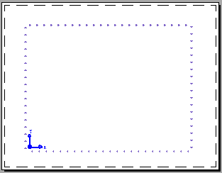

This is a relatively rare occurrence, but it's important to know that if you lock the layer on which the viewport "frame" has been created, when you double-click into that viewport, the frame will appear dotted. One of my customers bumped into this and once we found out what was causing the frame to be dotted, I made a note to pass it along.

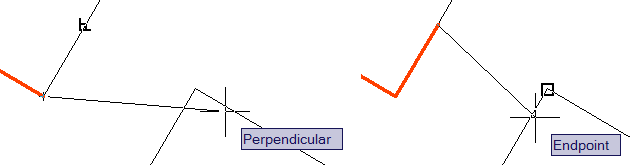

In the first figure, Snap to Perpendicular has been initiated and the cursor is placed close to the line whose extended vector would intersect the target line. Once the vector of the line has been acquired, a Perpendicular tool tip appears on the target line at the point where the vector of the acquired line would intersect the target line at a 90 degree angle. When you see the Perpendicular tool tip, click your cursor to place the point.
The second figure indicates the placement of the point of the polyline at the location of the Perpendicular tooltip, and at this point (so to speak), you can continue placing points of the polyline.
