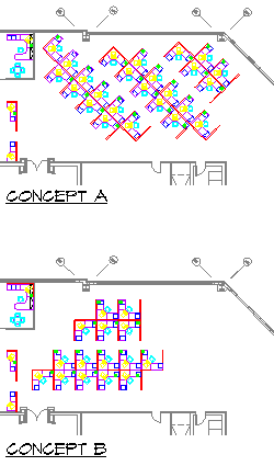

XCLIPMany of my customers will Xref the base architectural plan, then add the furniture; wonderful idea. One of my customers in San Diego reminded me of the Xclip feature and showed me how they were using it, so I thought I'd pass it along. The following procedure requires that you have an Xref (Attached or Overlaid, it doesn't matter), and some other objects that are not part of the Xref. In the example, I am using the drawing from the A2005 Sample folder, 8th Floor Furniture.DWG, if you want to follow along.
Xref
Instructions to Use XCLIP
  1. First, I would recommend using the Copy command and copy the Xref and objects you will be including in the selection.
  2. Type XCLIP or, from the Reference toolbar, click Clip Xref.
  3. When prompted to select objects, use a crossing window and select the area with the Xref and the objects to be included in the procedure, then press Enter.
  4. Press Enter for the default option for <New>, then use either the Polygonal or the default of <Rectangular>.
Xref clipped
  1. Draw the rectangle (or polygonal shape if you used that option) around the area containing the objects and the Xref that you want to KEEP. The area of the Xref you do not include will be "clipped" and essentially disappear
  2. After creating the rectangle (or pressing Enter if you're using Polygonal), the Xref not included in the clipping procedure is no longer visible!
Of course the Xref is still there, but AutoCAD has used the concept of clipping planes (usually encountered in 3D applications; see Michael's Corner March 2006 to accomplish the desired result.
Other Stuff You Should Know
  1. Set the variable XCLIPFRAMES to <1> to see the edge of the clipping frame.  It is NOT editable; I tried.
  2. To turn Off the clipping frame and see the Xref in its entirety, launch the XCLIP command again, select the objects, then use the OFF option. This retains the integrity of the clipping frame so you can turn it ON again.
  3. Use the Delete option of the XCLIP command to get rid of the clipping frame and start again.
  4. If you select the previously selected/clipped area and use the <New> option again, you will be prompted to delete the old clipping boundary.
  5. You can copy the result of the Xclip procedure, too (as shown in the two Concept plans)!

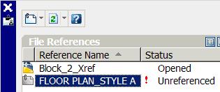

Xref Manager
  1. One last thing: Open the External Reference dialog box/window by typing XR and notice that the Xref is currently Unreferenced. If you have A2007, click the filename, then right click and select Reload. For all other versions, click the filename then click the Reload button.
Job done.
