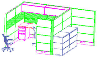

3D OrbitLast month I showed you a bit about the fundamentals of 3D Orbit. Let's go one more step and see how you can get an interior elevation of a 3D space. Since I work quite a bit with the contract furniture industry, I'm going to use an 8' x 8' workstation as an example.
If you would like me to send you the 3D drawing I am using in this exercise, email me and ask for the "3D Workstation".
Let's say you want to want to walk into the workstation and turn to your right such that you're looking from the left toward the right. Here's how to make it happen:

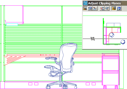

Then… Right-click for the shortcut menu and click MoreAdjust Clipping Planes to open the Adjust Clipping Planes dialog box. Your 3D drawing will appear in plan view with a horizontal line above and below the plan. The one below is the Front Clipping Plane; the one above is the Back Clipping Plane.
Now… Click the button for Front Clipping On/Off to turn on the clipping plane (the one at the bottom).
And… Put that funny looking cursor on the horizontal line of the Front Clipping Plane and drag it north … slowly. In the drawing you will see the 3D objects being clipped as you drag that line into the workstation.
Clipping Plane
After you close the Adjust Clipping Planes window and Exit 3D Orbit, smart money says you will save the view by name. Take a look at the Basics section from June 2003 if you're unfamiliar with that procedure.

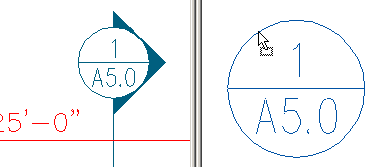

Have you ever been working along and wrote down the steps to do something and thought, "Ooh, I have to make sure I pass that along"? I was training the wonderful design team from the Madison & Milwaukee offices of Interior Investments when I put something on the board that is a great tip when using the tool palette.
Scenario: Someone sends you a drawing and in that drawing you see a really cool block that you would like to add to you tool palette.
Insert
Problem: If you drag and drop that block directly onto your palette from the drawing (A2005 & A2006 only; A2004 users have to do it from DesignCenter), you have established that drawing as the "source drawing" for the block. If the drawing is renamed, archived, or deleted, the block on your palette is… "toast" (I put that in for my friend in Sao Paulo).
Suggestion: Don't drag anything onto your palette from a drawing that you can't keep track of. Put it in a drawing you have dedicated as a source drawing for all your blocks. Let's say you have one called Block_Source.dwg…
Instructions to Efficiently Add Blocks to a Palette
  1. Open the drawing with the cool block.
  2. Open your source file, Block_Source.dwg.
  3. Tile your drawings vertically using WindowTile Vertically.
Drag and drop
  1. Click on the cool block, then click and drag it into the source file.
  2. Save the source drawing.
  3. Drag cool block to the palette.  Job done.
