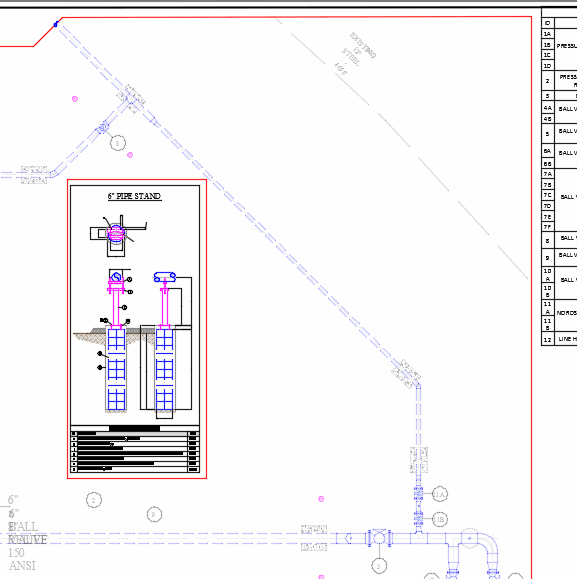

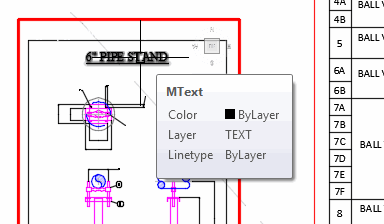

In the following exercise, my Model space contains a Pipe Stand detail, along with a site drawing. The large viewport will be of the site, and is the viewport that I will set the transparency for all the layers.
I'll make a smaller viewport set inside the larger viewport, and that's the view where I will zoom up to the detail.
How To Overlap a Viewport with Transparent Layers
  1. Create a new viewportOn a layout tab, create a large viewport and zoom to the desired area.
  2. While you're still in Paper space, create a second, smaller viewport within the larger one.
  3. Double-click in the large viewport, then use Ctrl + R to toggle into the small viewport. Change the view in the small viewport as necessary. In this example, I zoomed up to the pipe stand detail.
  4. Toggle to the large viewport, then open the Layer Properties Manager.
  5. Right-click anywhere, then click Select All.
  6. Under the VP Transparency column, click any 0 in the list, enter a value of 75, then click OK.
    Transparency value
  7. Close Layer Properties Manager and you'll see the change in the large viewport, but the smaller viewport remains with the default layer display!
It's not something you're going to encounter all the time, but I thought it was pretty cool!!
Note: To remove the viewport override transparency setting, select all the layers, then right-click Remove Viewport Overrides ForAll LayersIn All Viewports, or whatever combination you would prefer.
Gold Star Tip: After configuring the transparency of those layers in a viewport, you may want to consider saving that condition as a layer state if you want to return to it again in that drawing, or use it in a different viewport.

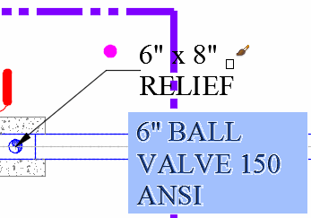

Masked textThe Background Mask feature has been around since Express Tools were a separate download, and it hasn't changed since I first covered it in July 2005 [See Michael's Corner Odd Spot, July 2005].
At our Semco Energy training, I was quite pleased to see that when using Match Properties, the background mask—applied to Mtext from within the Mtext Editor—is also matched.
However, if you want to apply the background mask properties coming from Mtext to Dimension text, not so much. Even more curious, is that when you are editing Dimension text, the shortcut menu doesn't have a Background Mask option!
How To Apply a Background Mask to Dimension Text
  1. Add a dimension to your drawing with the dimension text over the top of other objects.
  2. Background colorSingle click the dimension, then right-click Properties.
  3. Under the Text heading, change the Fill color… to Background!
    Masked dimension
Note: When editing Dimension text, even though the Text Editor contextual tab appears, the Mask item on the Style panel won't apply a background mask to the dimension text currently being edited. Squirrely.
