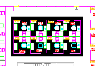

Case in point, you place a rectangle/pline around an area on the floor plan that is, say, the Accounting Department. Now you want to hatch that area, but by default, when you hover in a closed area with furniture 'islands', the hatch goes around the furniture.

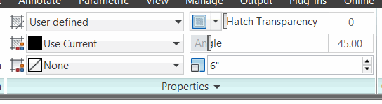

    Now you'll want to draw a hatch on the desired layer with the settings you will want to use each time you hatch a Department or when you will want to select an object for hatching.
    Properties
    In this exercise, I created a crosshatch pattern using the User Defined hatch pattern with a distance of 6″ at an angle of 45 degrees.
  6. After configuring the hatch properties, add the hatch to your drawing.

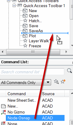

  4. Open the CUI. Under Command List, click Create a New Command to create Commandx.

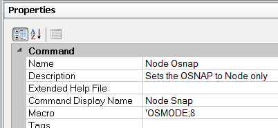

  5. Click your new 'Commandx' to open the Properties panel on the right side of the CUI.
    Properties panel
  6. Drag to the QATAdd the values similar to those shown in this figure for Name, some type of Description, and Command Display Name. Your button will now be alphabetized in the Command list.
  7. Edit the Command String field to read as follows (notice the apostrophe at the beginning)
    'OSMODE;8;
    The apostrophe runs the OSMODE command transparently. Since you usually discover that the Osnap is off when you're in the middle of a command, this button will set the Osnap while the command is still running.
  8. At this point, click Apply to apply your edits to your new command.
  9. To add your new button to the Quick Access Toolbar, drag it from the Command list and release it where you want it up on the Quick Access Toolbar. You should be good to go!

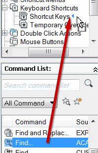

  1. Open the CUI dialog box by typing CUI at the command line.
  2. In the Customizations pane, expand Partial CUI Files, then expand Custom. Now expand the Keyboard Shortcuts node.
  3. Under Command List, drag the Find command up into the Customizations pane and release it next to Shortcut Keys to add it to the listing.
    Note: If the recently added command does not initially appear in the Shortcuts pane, you may have to OK out of the CUI, then re-open it.
  4. ShortcutsIn the Shortcuts pane next to the Find command, click in the Keys column to display an edit box — confirm NumLock is Off — then hold down Ctrl + F and press [Enter]. The Find command will now alphabetize in the list, and you should now see a green checkmark in the column preceding the Find command name.
  5. Click OK to close out of the CUI, then hit Ctrl + F to launch Find!

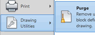

    PurgeNote: Yes, the Delete Duplicate Objects icon looks virtually identical to the Purge 'broom', which is why I didn't see it at first. Purge is located on the File pulldown menu or in the Application menu (red 'A')Drawing Utilities. But most folks just type PU (the alias for Purge).
