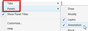

  2. Tabs and PanelsNow, configure the position of your toolbars (or the panels and tabs of your Ribbon) to suit your way of working. To turn off panels or tabs on the Ribbon, right click on any panel and you see an item for Tabs, as well as Panels.

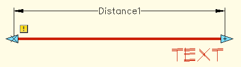

  5. On the Parameters tab of the Block Authoring Palettes, click Linear Parameter, then accurately snap to the left endpoint, then the right endpoint of the polyline. Place the Distance label above the line, just like you would a dimension line.
Distance 1
  1. Select the Distance label, then open Properties. Scroll down and change the Number of Grips value to 1. This setting will result in one parameter (cyan arrowhead) on the right endpoint of the line. You can now close the Properties window.
