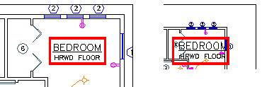

Doberman's get a bad rap; they're actually very friendly, you just need to get to know them… kinda like the new Annotative Text feature in A2008. This article is intended as a "Meet and Greet". There's more to know about it, but we need to make the introductions, first. We'll do so using an existing drawing with text objects.
Intended to make annotation more "viewport-compliant", a text object with Annotative Text set to "Yes" in the Properties window will automatically adjust if the viewport scale changes. Essentially, you get to specify the text height if it were to be measured in Paper space, and AutoCAD automatically adjusts the text to that height. It's really pretty sweet.

To follow along with the exercise, you will need text in Model Space and a layout with a viewport. If you would like, you can use Blocks and Tables – Imperial.DWG found in the ..\Sample folder of A2008. I'll be using that to illustrate these fundamental principles.
Begin the exercise from a layout tab with a viewport active.

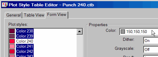

I'm aware of how they work, but since I don't plot out drawings for my customers, I haven't had a chance to investigate the power of Plot Styles. However, one of my customers in New Jersey turned me onto this really simple method to emphasize objects using a Color-based plot style table (CTB).
The goal of the exercise is to use color to emphasize specific geometry in a drawing. For example, you may want to emphasize the fixtures in a reflected ceiling plan or the utility lines of a site plan. In those circumstances, the objects to be emphasized may have a unique color or color number.
The best approach is to begin with the default acad.CTB (or aclt.CTB for those of you with AutoCAD LT), then create a new one from there.
