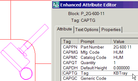

Enhanced Attribute Editor
Bottom line: If you have an attributed block in which you do not see the attributes, the Enhanced Attribute Editor may not be the solution for viewing those attributes. Battman just may be your hero.
Text Options
For example, the Enhanced Attribute Editor illustrations show an attributed keyboard tray block reference in which the attributes are not shown on the block in the drawing, but the Value for the tag is KBTray and the attribute has a text height of 3". So why don't you see the tag on the block? You'll need to use Battman to investigate the definition of the blocks.

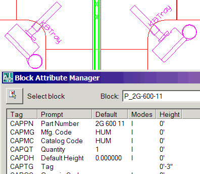

  1. On the Modify II toolbar, click Block Attribute Manager, or type BATTMAN to open the dialog box.
  2. Click Select Block, then select the block with attributes that you currently don't see.
In the illustration above, you will notice the Modes column displays an "I" for the CAPTG attribute, indicating that the value for that attribute was originally defined to be Invisible. You will also see that the Height for this block definition is set to 0'.

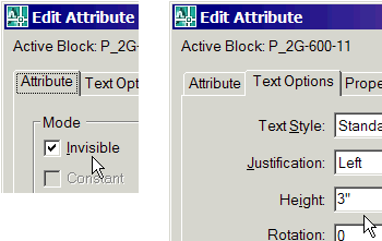

  1. In the list of tags, select the tag whose conditions you want to change, then click the Edit button to open the Edit Attribute dialog box for that tag.
Edit Attribute
  1. On the Attribute tab, clear the check box for Invisible.
  2. On the Text Options tab, enter the desired height for the attribute.
Auto Preview Changes
After configuring the values in the Block Attribute Manager, all references of that block in the drawing will be automatically updated if the check box for Auto Preview Changes is checked in the Edit Attribute dialog box.

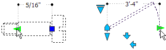

You must admit, dynamic blocks are pretty cool. In my on-site AutoCAD 2006 & 2007 training I show my customers how to create dynamic blocks, and in November 2005 I covered the unique characteristic of the Alignment Parameter. Recently I bumped into this feature and made a note to pass it on to you, so here it is:
Dynamic Input
If you have a dynamic block for which you have a linear parameter (a parameter enabling you to dynamically change the size of the block), when you select the block, then just hover over the parameter, the size of the block will be displayed IF you have the Dynamic Input button pushed in (On) on the AutoCAD Status bar.
Dynamic Block Examples
To check this out, open the sample Tool Palettes, go to your tab of choice (Architectural, Civil, Mechanical, etc.), then place a block which has the possibility of different sizes. Now click once on the block to select it, then hover over the Linear Parameter icon (the elongated triangle) and you'll see the current size of the block.
