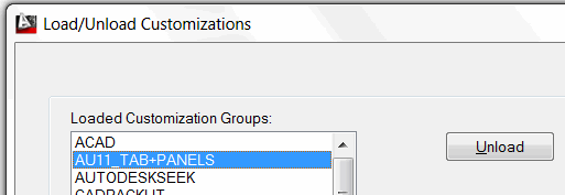

Gold Star Tip: To unload your custom tab, use the command CUILOAD, select the name of the menu to unload, then click Unload.
Unload

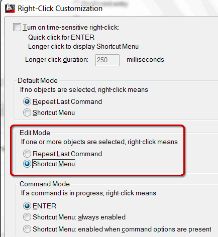

  • Disables the right-click menu if configured in Options. My preference for the Right-click menu is, essentially, to make it as useful as it was back in Release 14. [See screen capture for the Right-Click Customization feature found in OptionsUser Preferences tab].
    With PICKFIRST set to <0>, if you select an object, then right-click for a menu, you won't get the expected menu, per the setting under Edit Mode shown in the figure.

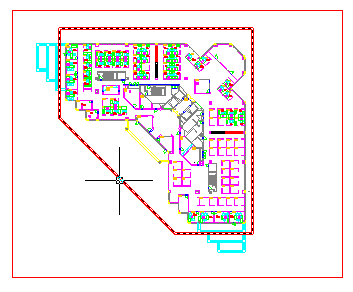

  3. Return to Paper space and create any closed polyline, spline or circle to be the viewport. In this illustration, I created a polyline around the perimeter of the floorplan.
    Draw a closed polyline
    Note: You must use the Close option of the Polyline command if it is to be converted into a viewport. If you did not use the Close option, use Pedit and select the polyline, then use the Close option.

Clipped viewportAutoCAD will convert the polyline into a viewport and erase the original rectangular viewport!
