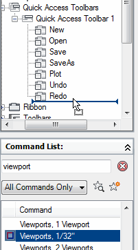

  10. Drag to QATTo add this button to the Quick Access Toolbar, in the top left quadrant of the CUI, expand Quick Access Toolbars, then expand Quick Access Toolbar 1 to display the current content of your Quick Access Toolbar.
  11. Now drag and drop your new Viewports, 1/32″ command up into the Quick Access Toolbar command list.
  12. Click OK to save your edits and close the CUI.

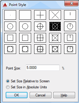

Point Style Dialogue BoxThe AutoCAD-based furniture specification software used by many of my customers—Aflac, Safeway, and Yum! Brands, to name a few—has Point objects on the corners of the furniture blocks. Then, when placing the furniture, the Designer uses Node snap to accurately place the components.
Point Style on the RibbonAnd, as has happened to most people reading this article, sometimes you Zoom/Extents and your drawing ‘disappears’.
Of course, the first place you check is for layers that have been turned Off, but the solution that helps my furniture folks, is to adjust the Point Style to something more visible. [Home tabUtilities panelPoint Style]
Recommended
Resultant PointI typically use the style of the Circle with the X as shown in the figure [PDMODE = 35 for those of you who like to know the variables], and then notice that the size is ‘Set Size Relative to Screen’. This will cause any random/misbehaving Point object to be plainly visible.
