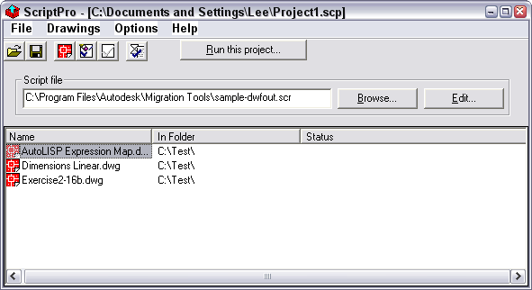

ScriptPro is a utility that has been around since about AutoCAD 2000, but in recent years has been lost in the shuffle of new releases. Back in the early 2000's around the time of AutoCAD 2000 and 2000i, AutoCAD shipped with an additional set of utilities other than Express Tools - which were very cool in their own right. ScriptPro, as its name suggests, allows you to work with script files. It does not turn you into a script writing professional though, as it does not actually help you write script files at all.
ScriptPro
You use ScriptPro to run a script file on a drawing or set of drawings which helps you to increase productivity and enforce consistency between drawings. So if you need to batch process a set of drawings to update layers, save the drawings to a specific file version, set the Model tab current, or perform a zoom extents on each of the drawings. You can download ScriptPro from the Autodesk website.
Instructions to Run a Script on a Set of Drawings
  1. After you install ScriptPro on your workstation, click Start[All] ProgramsAutodeskScriptProScriptPro.
  2. In the ScriptPro dialog box, under the Script area, click Browse.
  3. In the Open dialog box, browse to and select the script file that you want to run on each selected drawing. Script files have a SCR file extension.
  4. Click Open.
  5. On the toolbar, click Add Drawings.
  6. In the ScriptPro - Add/Remove Files in Drawing list dialog box, browse to the folder that contains the drawings you want to process.
  7. In the Drawings list, select a drawing and click >> to add it to the Files to Apply Script list. You can also remove files from the list by selecting the drawing in the Files to Apply Script list and then click <<. I recommend creating an archive of the drawings you want to run the script file on just in case something goes wrong, which never happens until you are doing something in the final hours of a project.
  8. After you added the drawing files to be processed, click OK to return to the ScriptPro dialog box.
  9. On the toolbar, click Save a ScriptPro Project.
  10. In the SaveAs dialog box, browse to the location that you want to save the script project file to and provide a file name for the project file. You can reload the project file later and process the same drawings again with the same script file or another script file.
  11. Click Save.
  12. After saving the script project file, click Run this Project.
  13. The ScriptPro - Running dialog box is displayed and shows the progress of the drawing each drawing. A new session of AutoCAD. The first drawing is opened and the script is run.
  14. Once all the drawings have been processed, the ScriptPro - Project Completed message box is displayed. Click Yes to view the log file to view if any problems were encountered and what they might have been.

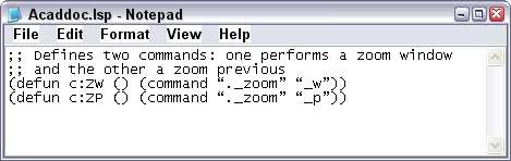

Once the command is defined, you can automatically load it each time AutoCAD starts up by creating a file with the special name Acaddoc.lsp, or create an AutoLISP file with a name of your choice and then add it to the Startup Suite in the Load/Unload Application dialog box.
Instructions to create a simple Custom Command with AutoLISP
  1. Start the Notepad text editor; click Start[All] ProgramsAccessoriesNotepad.
  2. In Notepad, enter the following text:
;; Defines two commands: one performs a zoom window
;; and the other a zoom previous
(defun c:ZW () (command "._zoom" "_w"))
(defun c:ZP () (command "._zoom" "_p"))
Acaddoc.lsp
  1. From the menu bar, choose FileSave As….
  2. In the Save As dialog box, select "All Files" from the Save As Type drop-down list.
  3. Browse to one of AutoCAD's support paths or add a new support path on the Files tab of the Options dialog box. Enter the name Acaddoc.lsp in the File Name box and then click Save.
  4. Switch to AutoCAD. Then save any files that are open and close AutoCAD.
  5. Restart AutoCAD and create a new drawing. Then type ZW or ZP at the command prompt. If Acaddoc.lsp was found by AutoCAD the new commands should work.
The example (defun c:ZW () (command "._zoom" "w")) breaks down as follows:
(defun c:ZW () - The Defun function creates a new command that can be typed at the command prompt named ZW.
(command "._zoom" "_w")) - The Command function tells AutoCAD that you are using the following commands and options. So the example uses the ZOOM command with the Windows option.
The lines that start with a ; (semicolon) designate lines in the file that are used as comments and do not get executed or loaded into AutoCAD.

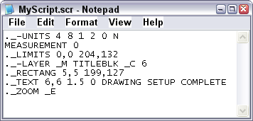

Script files are one of the most natural forms of customizing AutoCAD because it uses the same input and the commands that you are already familiar with. There are a few differences, the first difference that you need to understand is that you cannot prompt for user input and the other main difference is that you cannot use commands that display dialog boxes. To work around the issue with dialog boxes, you use the commands that are prefixed with a dash. For example, to create a layer using a script you would use the -LAYER command instead of the LAYER command. Script files are created using a plain ASCII text editor such as Notepad.
The following is an example of a script file that performs some basic drawing setup:
._-UNITS 4 8 1 2 0 N
MEASUREMENT 0
._LIMITS 0,0 204,132
._-LAYER _M TITLEBLK _C 6
._RECTANG 5,5 199,127
._TEXT 6,6 1.5 0 DRAWING SETUP COMPLETE
._ZOOM _E
MyScript.scr
In the above example, you do not see all of the special characters such as spaces and line returns or enters that are needed to create the script. The following shows the same script except with spaces represented as <SP> and enters or linefeeds represented as <ENTER>. Note the 2 spaces after the 6 on line 4.
._-UNITS<SP>4<SP>8<SP>1<SP>2<SP>0<SP>N<ENTER>
MEASUREMENT<SP>0<ENTER>
._LIMITS<SP>0,0<SP>204,132<ENTER>
._-LAYER<SP>_M<SP>TITLEBLK<SP>_C<SP>6<SP><SP><ENTER>
._RECTANG<SP>5,5<SP>199,127<ENTER>
._TEXT<SP>6,6<SP>1.5<SP>0<SP>DRAWING SETUP COMPLETE<ENTER>
._ZOOM<SP>_E<ENTER>
The first line ._-UNITS 4 8 1 2 0 N sets the units to Architectural to a precision of 1/8″ and angular units of Decimal Degrees to a precision of 2. The last two values control the angular direction.
The line MEASUREINIT 0 defines that the drawing should use Imperial measurement for the current drawing which affects the hatch pattern and linetype files that should be used along with a few other features.
The line ._LIMITS 0,0 204,132 sets the drawing limits.
The line ._-LAYER _M TITLEBLK _C 6 creates a new layer named TITLEBLK and sets it to the Magenta color.
The line ._RECTANG 5,5 199,127 draws a rectangle starting at 5,5 and ending at 199,127.
The line ._TEXT 6,6 1.5 0 DRAWING SETUP COMPLETE creates a single line text object that is 1.5 units in height at 6,6 with a rotation of 0 and with the text "DRAWING SETUP COMPLETE".
The line ._ZOOM _E performs a zoom extents.
Instructions for Writing and Running a Script
  2. In Notepad, enter the text from the above sample script file (or just copy and paste).
  3. From the menu bar, choose FileSave As….
  4. In the Save As dialog box, select "All Files" from the Save As Type drop-down list.
  5. Browse to the location where you want to save the script file and enter the name of the script file in the File Name box. As an example, enter MyScript.scr.
  6. Click FileSave.
  7. To run the script file, switch to AutoCAD and create a new drawing.
  8. Select ToolsRun Script.
  9. In the Select Script File dialog box, browse to and select the script file.
  10. Click Open. A magenta rectangle is drawn and the text "DRAWING SETUP COMPLETE" is displayed in the lower-left corner of the rectangle.
If you press F2 after the script has run, you can see all the command prompts and how they are answered.
