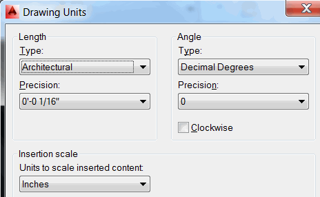

In the following exercise, you write a script that launches the command line version of the Units command and sets the values to the ones shown in this figure.
Drawing Units
If you would like to configure the values to something other than what is shown here, type -UNITS at the command line and follow the prompts, then use those numbers to replace the ones here.
Also, you may replace the layer being created in the following script—A-FURN—to one that you would like to have in each drawing you work on.

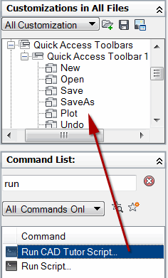

Next, we need to put it on the Quick Access Toolbar, so we'll Duplicate the existing ‘Run a Script’ button and edit it to select our Script.
How to Add a Script to the Quick Access Toolbar
  1. Open the CUI.
  2. Expand the Quick Access Toolbars, then Quick Access Toolbar 1.
  3. Under the Command list, navigate to Run Script.
  4. Drag and drop the new commandRight-click on Run Script, then click Duplicate. This is essentially a Copy/Paste routine which retains the integrity of the original command. We will edit the one that has an Element ID with the prefix of ‘MMU’ (before you ask, I have no idea).
  5. Here's what I put in the Properties fields:
    Name Run CAD Tutor Script
    Command Display Name Drawing Setup
    Macro '_script;MC_FEB14
  6. Drag your new command up and release it in the list of commands under Quick Access Toolbar 1.
  7. Click OK to save your edits and close the CUI.
