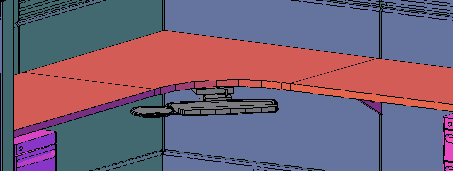

Move with a <Displacement>
Before MoveWhen moving an object with the Move command, after selecting the objects, you're given the option of specifying a basepoint — which virtually everyone will do — or enter a <Displacement>. A what??
This recently came up when a my customer needed to move several furniture objects in 3D. In this exercise, I move the three work surfaces and the keyboard tray up by 12″.
Insights
  • The key to this option is to enter the distance (the 'Displacement') in X, Y, Z format.
  • If you're only moving in the X or Y axis, you don't have to enter the Z value.
  • You don't need to precede the entry with the @ sign if you have not specified a base point.
  • After entering the desired displacement value, you need to press [Enter] a second time to complete the command.

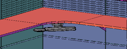

How To Move Selected Objects Using <Displacement>
  1. After MoveLaunch Move, select the objects, then press [Enter].
  2. At the prompt to Specify Basepoint… or <Displacement>:, enter the distance of the move in X,Y,Z format. To move the three work surfaces and the keyboard tray up, I entered 0,0,12.
  3. At the prompt to Specify second point or <use first point as displacement>: press [Enter].

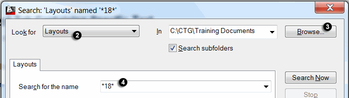

Using Search in Design Center to Find a Layout
Design CenterIt's been awhile since I wrote about this, but I wanted to revisit this feature in DesignCenter. DesignCenter [Insert tabContent panel] was introduced in AutoCAD 2000 and has several features that are quite powerful, one of them being Search.
My friend, Tracy Lincoln, sent me a note about the Search feature in DesignCenter and it really is amazing! Let's say you're looking for all the drawings with an 18x24 title block on the Layout tab.
How to Search for a Layout Tab Containing Specific Text
  1. SearchOpen DesignCenter (Ctrl + 2) then click Search to open the Search dialog box.
  2. In the ‘Look for’ drop-down list, click Layouts.
  3. Click the Browse button, then navigate to a folder or drive containing the drawings you want to search through.
  4. In the ‘Search For The Name’ field, enter the text string — such as *18* to find all layout tabs with 18x24 in the name — then click Search Now.

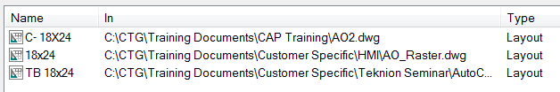

    Search
  5. After the search is complete, double-click on the layout you to want access and DesignCenter will then navigate to the drawing matching that search criteria ("18" and a Layout tab in this example).
    Search results
