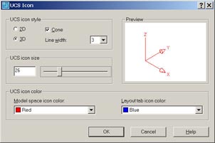

UCS Icon and Its Properties
One of the first things to remember is that the only setting for the UCS icon that is constant across all drawings are those that are set in the UCS Icon dialog box which is accessed via the Properties option. All other options are per drawing. In the UCS Icon dialog box you can specify the icon graphic, its width size and color. You also have an option for the color in Model and Paper space.
[ON/OFF/Noorigin/ORigin/Properties]
Other things to consider with the UCS icon:
  1. To force the UCS icon down into the lower left corner, use the Noorigin option.
  2. If you don't work in a vacuum, remember that any drawing you open, whether it originates from within your company or not, may have a unique UCS position.
  3. When you reposition the UCS Origin (as in Step 3 of the lead article this month), remember that the icon will not anchor to the origin unless the UCSICON option of ORigin has been specified. (Or set via the lengthy process from the View menu).
Note: If the UCS icon does not anchor to the UCS origin, it is probably because the graphic of the icon itself cannot be completely displayed based upon the position of the UCS origin within the display. Pan your drawing and the icon will probably re-appear on the Origin.
