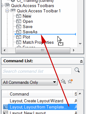

Now I'm on a crusade to see how many cool things we can put on the Quick Access Toolbar [QAT]. Admittedly, you won't want everything up there, but your favorite Layout Tabs — A-Portrait, A-Landscape, etc. — would be nice to have.
Prerequisite: A drawing (.DWG or .DWT) with the layouts configured for the desired sheet sizes with their associated title blocks.
Need-To-Know: The path and filename of this drawing (needed for step 8, below).
How to Configure the QAT to Access Your Layout Tabs
  1. Launch the CUI, then expand Quick Access Toolbars, then Quick Access Toolbars 1 to display the current content of the QAT.
  2. Under the Command List, navigate to Layout, Layout From Template, then drag it up and release it in the list of QAT commands.
  3. Now click on the command in the list to display the Properties in the lower right area of the CUI.
  4. In the Macro, click at the end of the existing string, and use Backspace to eliminate the space that follows the word ‘template’.
  5. Insert layoutAfter the word ‘template’, add a semi-colon, this equates to ‘press [Enter]’. Then in quotes, add the name of the .DWG or .DWT containing your layout tabs.
    What you add should look similar to the text in red where your filename (with the proper extension) is in quotes:
    ^C^C^R_layout _template;"MY TITLEBLOCKS.DWG"
  6. Click OK, to save your edits and close the CUI.

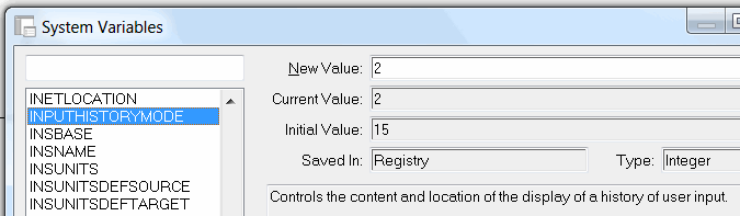

I was contacted by a user at EDS Corp. outside Chicago about the curious operation of Up arrow on the keyboard and the Command history. As some of you know, you can hit the Up arrow on your keyboard to display the commands you used; either selected or typed.
Dave's question was, why he couldn't Up arrow to get the previous value entered for a distance? For example, he begins the line command, turns on Ortho, moves the cursor to the right and enters, say, 100.
Now he moves the cursor up, hits the Up arrow, and gets…
Coordinates??
The command line
It took me a few minutes, but I tracked it down to the default value for the variable called INPUTHISTORYMODE. Check out Express ToolsTools panelSystem Variable Editor. I've written about this collection on a number of occasions, and here's another one.
System variables
I didn't understand the phrasing of the various settings, but the default of <15> wasn't working for him. As it turned out, an INPUTHISTORYMODE of <2> did the trick.
