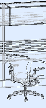

I was hunting for something in A2002 and stumbled on this. If you want to see the hidden lines of a 3D drawing, use the "Obscured" variables.
The Players…
Hidden Lines
OBSCUREDLTYPE
Available settings:
OBSCUREDLTYPE settings
1 Solid
2 Dashed
3 Dotted
4 Short Dash
5 Medium Dash
6 Long Dash
7 Double Short Dash
8 Double Medium Dash
9 Double Long Dash
10 Medium Long Dash
11 Sparse Dot
OBSCUREDCOLOR
Enter the color number of your choice.
The Game…
It's pretty easy. Once you have a drawing with 3D objects (solids, optimally), simply enter the values for these obscure variables (literally) and run the Hide command.
