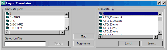

Layer Translator
Let's say you receive several drawings from the same contractor on a particular project and they use a layer named AR-Wall but your layer standard is A_Walls. AutoCAD's Layer Translator (located on the CAD Standards toolbar or from ToolsCAD StandardsLayer Translator) may be the solution.
Layer Translator
Ideally, you would have a "master" drawing or template which contains your layer list. Using Layer Translator, you can then "map" the other drawing's layers to your layers as you'll see in the following procedure.
Instructions to Map Layers of a Drawing to Your Layer Standard
  1. Open a drawing for which you would like to map their layer naming to yours. You may want to look at the drawing named "db_samp.dwg" in AutoCAD's ..\Sample folder.
  2. Open the Layer Translator dialog box where you will see the current drawing's list of layers under the Translate From listing…
  3. Click Load, then navigate to the drawing or template containing your company's standard layer list, then click Open and that layer list shows up under Translate To.
  4. Now you basically "connect the dots". Click one layer in the list on the left to Translate From, then you can click one or more layers (using Ctrl to click additional layers) under the Translate To list. After each "pairing", click Map. At that point, the Translate From layer you selected is now removed from the list. The goal of the exercise is to map all the layers from the left to the right. To map all the layers that have the same name in both lists - such as layer 0 and Defpoints - click Map Same.
Remove
Sidebar A: If you get "happy fingers" and mistakenly grab the wrong layer from the Translate From list, you will notice after you click Map that the mapped layers are displayed in the Layer Translation Mappings list. Right-click on the layer mistakenly mapped, then click Remove to put it back in the Translate From list.
Sidebar B: If you need to add a layer on the Translate To side to accommodate a layer from the Translate From side, click the New button to open the New Layer dialog box.
Files of type
  1. After translating all the layers, if you will be needing to use the same translation on other drawings you get from the same outside source, click Save to open the Save Layer Mappings dialog box and save a .DWS file.
  2. Click Translate to translate the layers.
Instructions to Use a DWS Translation File on Other Drawings
  1. Open the drawing from the outside source, then open the Layer Translator.
  2. Click Load and change the Files Of Type to Standards (*.dws), then navigate to the location where the DWS file was saved from the previous drawing.
  3. Select the DWS file, then click Open and the layers in the Translate From list that have been saved in the DWS file are mapped to the Layer Translation Mappings list. If additional layers remain in the Translate From list, you can map the additional layers and save the new DWS (or overwrite the existing one), or click Translate to complete the procedure.

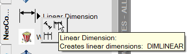

Instructions to Add a Dimension to a Tool Palette
  1. Set the desired dimension style and layer, then create a linear dimension.
  2. Open the Tool Palette window, then open the palette onto which you want to add the dimension.
  3. Click the dimension, then click on a highlighted element of the dimension (NOT in a grip) and drag it onto the palette.
  4. When you click the black triangle next to the icon, you will see an assortment of dimension routines. To edit the assortment, right click on the dimension icon, then click Properties to open the Tool Properties dialog box.
Note: Under the General heading, notice that the Layer and the Dimension Style settings reflect the settings that were current when you added the dimension to the drawing.
Flyout Options
  1. Under the Command heading, click the Flyout Options field, then click the browse button on the right side to open the Flyout Options dialog box.
  2. Clear the checkboxes for those dimension features you will not me needing very frequently, then click OK to close both the dialog box for the Flyout Options and Tool Properties.
  3. Now you can go to any drawing that doesn't contain your dimension style or layer and when you add a dimension to the drawing from that tool palette, it will be just as you like it!

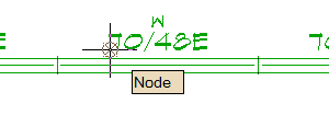

One thing that has bothered me over the last several versions is when a Node snap marker comes up when I get near an Mtext object or an Attribute! What's up with that?? The other thing that is bothersome is the new Shift+Spacebar thing to cycle through objects occupying the same location (See October 2007, Odd Spot).
Well, there's a solution to both of them. One of my top-notch customers at Iowa State reminded me of the fix for the cycle through objects thing (Thanks, Paul; I hope your brother enjoyed his new Bowling Green "baby"), and the other one I just bumped into researching another customer's problem.
LEGACYCTRLPICK Set this to <1> and the method of cycling between objects reverts to the method used for many years where you put your pick box over the item, then hold down the CTRL key and click through the objects (See December 2003, Basics).
Node Osnap
OSNAPNODELEGACY - Set this to <1> also and you effectively disable that curious Node snap feature that shows up when you're in the midst of a command requiring you to specify a point… and a Node snap pops up on the insertion point of an Mtext object or an Attribute.
