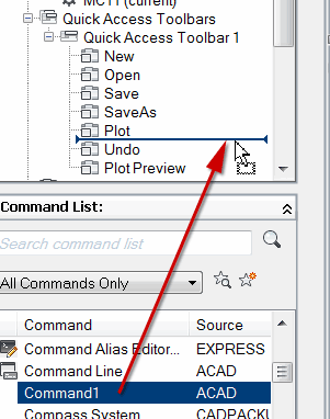

  1. Create a new command
    Open the CUI.
  2. Just above the Command list, click Create a New Command. You will see Command1 added to the list.
  3. Under Customizations in All Files, expand Quick Access Toolbars, then expand Quick Access Toolbars 1 to display your current QAT content.
  4. Drag and drop Command1
    Now drag your Command1 command up into the list of your QAT content.
    Note: Rather than dragging Command1 straight up across the ‘county line’ – which may cause the Quick Access Toolbar content to scroll away from you – drag it over to the middle section (I call it the ‘frontage road’), then drag it up to be parallel to the QAT content, then drag it into where you want to place it in the QAT list.

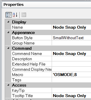

  5. When you click on your newly positioned Command1, the Properties for the command are displayed on the right side of the CUI.
  6. Properties
    Enter the text Node Snap Only for the Name, Command Name, and Tooltip Title.
  7. For the Macro, enter 'OSMODE;8
    Breaking it down…
    ' An apostrophe preceding the command will launch the variable as a nested process, without canceling the command that may be running.
    ; The semi-colon is used to press [Enter]. However, a semi-colon is not necessary after the last character entry of the string.

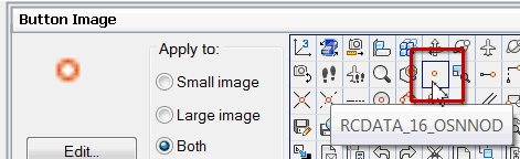

  8. At the bottom of the Properties, click in the field for the Small Image.
  9. Up in the collection of Button images, click the dot representing Node snap, to assign that image to your new command.
  10. Click OK to complete the customization and close the CUI.

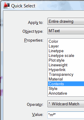

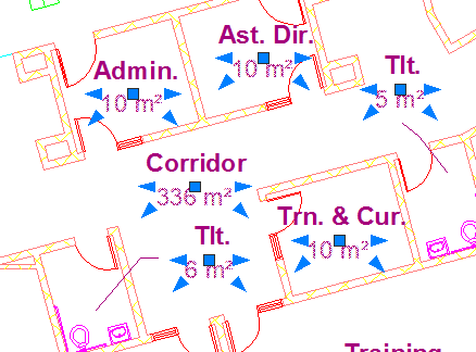

I was working on a customer's drawing the other day that had text that stated the area in square meters as ‘m2’, so I was wondering how I could highlight and select just the text with that string of characters. The Select Similar command, while very powerful in its own right, does not allow for a search string to be used as one of the criteria.
Drawing with text
The solution? The good ole standby, Quick Select! I covered Quick Select back in March 2003, so I think it's time to revisit this one.
How to Select Text Using a Wildcard
  1. Quick Select ButtonThe Quick Select command is the upper right tool on the Properties palette [Ctrl + 1].
  2. Quick Select dialog boxIn the scenario stated above, I set the Quick Select values as shown in the figure.
    Notice that when using the * Wildcard Match option that you will need to put the asterisk in the desired location. I found it best to put it on both sides of the text string.
    Note: This was a unique situation since the ‘squared’ character was a superscript. I first needed to double-click on the Mtext containing that text string, then highlight and copy the characters. Then I pasted them into the Value field for Quick Select.
  3. After configuring the conditions for the selection, click OK to apply the selection criteria and select the objects!

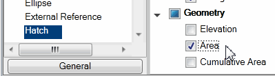

Quick PropertiesThe Quick Properties feature (covered in Michael's Corner, August 2009 & September 2009), can be customized to display the area of a Hatch, which I thought was pretty cool.
How to Display the Hatch Area on Quick Properties
  1. Add a hatch to any object in your drawing.
  2. Toggle on Quick Properties on the Status bar [QP], then click on the hatch to display the Quick Properties window.
  3. Right-click in the thick frame of the window, then turn off the Auto-Collapse feature (which I find to be a bit of a paradox for something that's supposed to be ‘quick’).
  4. Customize
    Right-click on the frame again, then click Customize… to open the CUI, organized to specifically allow you to edit the Quick Properties content for the Hatch object.
  5. On the right, in the list of possible properties, scroll to the bottom and check the box for Area (under the General heading).
  6. Area
    Select any additional bits of information you would like to see in Quick Properties for the hatch, then click OK to save your changes and close the CUI.
  7. Now, click on your hatch and notice the additions to the Quick Properties window!

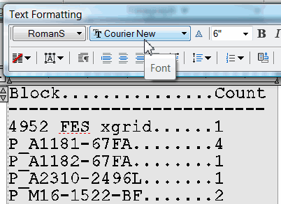

  3. Hit the F2 key to flip to the AutoCAD Text Window and see the resulting list of blocks. You may have to scroll up to get to the top.
  4. Bonus points: To get the count into the drawing, highlight the desired content, then right-clickCopy.
  5. Go back to the drawing, then hit Ctrl + V and click in the drawing to paste the selected content as Mtext. Standard Mtext editing procedures now apply.
Font = Courier New
Hint: There's a good possibility the Count column won't ‘line up’ the numbers. In the Mtext editor, select all the text (Ctrl + A), then change the font to Courier New… and they line up quite nicely.
