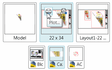

The Quick View features - Quick View Layouts and Quick View Drawings - may not be for everyday use, but they're really great when you need 'em.
Quick View Drawings is the most powerful, in my opinion, because it will display not only the open drawings, but also the layouts of those drawings.

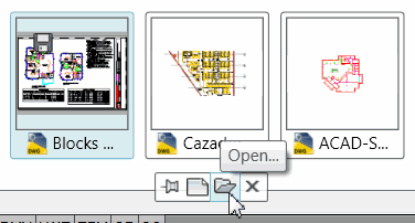

Open two or more drawings - ideally, drawings with multiple layout tabs - then take a look at some of these insights
.Click Quick View Drawings to display thumbnail images for the drawings that are currently open.
A menu appears with Pin Quick View, New, Open, and Close Quick View. Use the Pin Quick View if you are going to go to another Windows application, then return to AutoCAD.
When you hover on a drawing image, you have Save and Close icons in the corners… and the layouts for that drawing are displayed above it.
When you hover on a layout image, you have Plot and Publish icons in the corners.
Gold Star Tip: Use Ctrl + wheel scroll to increase or decrease the image size of the drawing or layout.
If you have a significant number of layouts, you will see an arrow in the layout image to dynamically scroll right (or left).
The Quick View Layouts feature displays layout images for the current drawing only. That's why I typically prefer to use the Quick View Drawings - I can display any drawing/any layout.

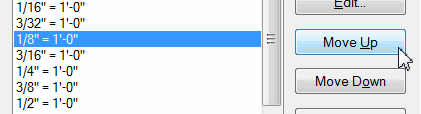

By default, when you switch over to a new layout tab, AutoCAD zooms to the drawing extents within the viewport.
To set the viewport scale, activate the viewport, then click Viewport Scale on the right half of the Status bar (the one that probably displays an odd decimal value) and select the desired plot scale from the list.
Open the Options dialog box (big red letter 'A'Options below the drawing name listing).
Click the User Preferences tab, then click Default Scale List (A2011) or Edit Scale List (all other versions) to open the dialog box listing the available plot scales.
To delete unwanted/unused plot scales from the list, select the ones you want to get rid of (pick & drag, or use Ctrl or Shift to make your selection), then click the Delete button.
Note: In case you delete the wrong ones or want to start over, click Reset. The Reset feature is also useful if you have an inordinate number of plot scales as a result of Xrefs in the current drawing.
To position your most frequently used plot scales, select the desired scale, then click the Move Up or Move Down buttons.
When you're finished, click OK to close and save your changes, then click OK to close the Options dialog box.
Important: The scale list is saved by Drawing. Therefore, it would be best to configure the plot scales in your template and at least that way, whenever you use your template, your edited plot scale list is available.
