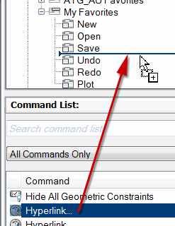

  3. My FavoritesRight-click the Quick Access Toolbar node, then click New Quick Access Toolbar and enter a name such as My Favorites. Click the plus sign (+) to display the default tools in your new QA Toolbar.
  4. Drag a favourite commandTo quickly customize this Quick Access Toolbar - so it looks different than the default - from the Command List, drag one of your favorite commands up from the list, and release it somewhere in your My Favorites Quick Access Toolbar list of commands. In the figure, you will see that I'm dragging up the Hyperlink command.

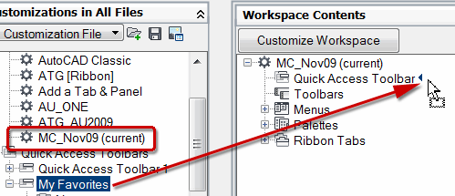

  5. Now, click on your Workspace name (up in the list of workspaces) to display Workspace Contents on the right.
  6. Drag your "My Favorites" Quick Access Toolbar over and release it next to the Quick Access Toolbar which then applies your Quick Access Toolbar name.
    Drag 'My Favorites'
  7. Click OK to save your edits and close the CUI. You should now see your additional tool(s) on the Quick Access Toolbar.

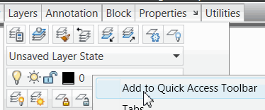

  1. On the Home tab of the Ribbon, the Layers panel, right-click in the area of the layer dropdown list, then click Add to Quick Access Toolbar.
  2. Um, there is no second step. You're done!
Layer Combo ControlI discovered the name of this thing when I went to the CUI and looked at the list of stuff that was on my Quick Access Toolbar and saw "Layer Combo Control". Works for me!

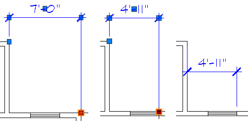

Have you ever noticed the dots at the bottom of the extension lines of a dimension? Those are the definition points - Defpoints - of the dimension. And as you may have intuited, those dots live on the Defpoints layer (and a collective "Ah-ha!" went up across the land).
The simple feature I want to present here is how easy it is to modify a dimension, simply by moving the position of the Defpoints.
Instructions to Modify the Dimension with Grips
  1. Add a dimension to your drawing.
  2. Click on one of the "defpoint" grips at the bottom of an extension line.
  3. Now snap that point to a new location using any object snap method.
  4. You can move the position of the dimension line using one of the arrowhead grips.
