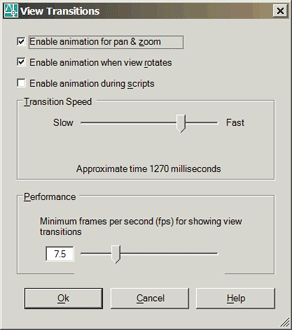

Those of you with AutoCAD 2006 have noticed the "elegant" way in which AutoCAD glides the view to display your drawing if you do ZoomExtents, use a Zoom window, or any number of other methods by which you change your view.
There's also a good chance some of you would like to eliminate that "feature"… (or maybe adjust those settings on the system of one of your favorite co-workers).
The View Transitions dialog box is the place where you can make the desired changes. If there are times when you would appreciate the transition effects, but other times you wouldn't, consider making a button (with a macro), a script, or a Lisp routine to change the settings.

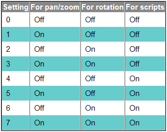

The variable VTENBLE has a valid range of 0 to 7 per the chart shown below.

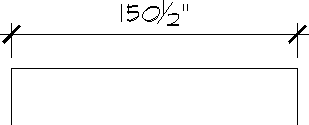

Inches Only Dimensions
For those of you who only want to see inches in your dimensioning, I would recommend that you create a new dimension style in your master drawing or template.
Settings for a Dimension Style to Display Inches
  1. In the Primary Units tab of the Dimension Style Manager, set the Unit Format to Fractional.
  2. To see the inch mark after the dimension value, put the " mark in the Suffix text edit field.
