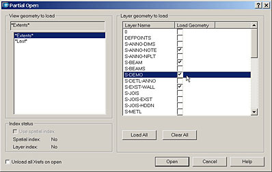

If you're not working in a vacuum, working on another guy's drawing is a part of life, so it's important to know how to keep clutter to a minimum. In the Select File dialog, the Partial Open feature lets you be selective about what layer "geometry" is loaded when you open a drawing. Choose Partial Open from the item drop-down to open the dialog, then check the layers of the geometry/objects that you would like to see in the drawing.
Tip: Smart money says you open the drawing first and turn on/thaw all layers so you know what you have, identify the layers you'll need, then close it and start Partial Open.
The geometry that has been created on the layers selected will be the only information that is physically opened and displayed. You will notice, however, that all the layers names for the drawing will be listed in the Layer dialog, even though the objects on those layers aren't loaded.
But what if you didn't get all the information you needed? Once a drawing has been partially opened, you can load additional layer geometry using File/Partial Load. The Partial Load feature is only available for drawings that have already been partially opened.
The Partial Load dialog box looks virtually identical to the Partial Open dialog with one exception: The "Pick a window" button. With this feature you can load additional layers in a user-specified area!

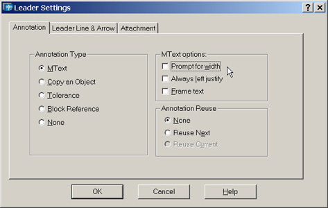

The Dimension toolbar has a great feature called Quick Leader. Press <Enter> to open the Leader Settings dialog where the default mode of annotation is Mtext. For the best results, uncheck the Prompt for width box under MText options. By doing so, you can type the note and press <Enter> when you're ready to go to the next line.

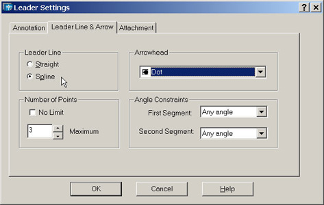

Another nice feature in the Leader Settings dialog is the Leader Line & Arrow tab which has a Spline option. I usually leave the Number of Points setting on 3.

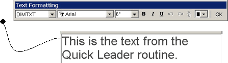

Click OK to close the dialog, then place the arrowhead position, the second point of the leader spline, then the final point where the text will be located. You are then prompted to enter the first line of text, but if you press <Enter>, the Mtext dialog opens.
Note: The height of the text is based on the text height of the current dimension style multiplied by the Overall scale factor found on the Fit tab of the Dimension Style dialog. Depending upon the font used, you can also change the character properties.
