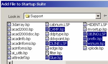

The Lisp files in this section are zipped for ease of distribution from my website. The following procedures should answer most of the questions you have regarding what to do. These steps presume you have AutoCAD 2002 installed in the default location.
Note: Those of you only interested in the numbering routines of Objno, Wsnum and Prefix, there is a separate .zip file called Numbers.zip containing those files only.
Once you have downloaded the zip files, here's what you will need to do:
