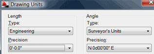

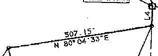

Surveyor's UnitsI was training some folks at Cummins Engine Plant in Indiana, and one of the guys brought in a surveyor's plan for his property and was wondering if he could take the distance and bearing values from the site plan and ‘key them in’ to AutoCAD.
So if any of you have a site plan of your property - or the site of your future construction - here's how this works.
Drawing Units Dialog BoxIf you turn on the DYN button, you can enter the values directly if you know the syntax used for Surveyor's Units. The Surveyor's Units are found in the Drawing Units dialog box [Format menuUnits], but it's not necessary to set that Angle Type if you use Dynamic Input as I present in this exercise.
How to Draw with Surveyor's Units
  1. Dynamic InputBegin a new drawing, then turn on Dynamic Input (DYN button) on the Status bar.
  2. Launch the Line command, then specify the first point.
  3. Enter the following value: @50.71′<N80d04′30″E
    Dynamic Input Format
Breaking it down…
@ After specifying the start point, @ says the following values are to go from where you're at.
Distance Enter the distance for that section of the property line (or road or culvert center line, etc.)
< This says the angle or bearing value is to follow…
Bearing Enter the bearing values in the proper format for Surveyor's Units shown in the example, above.

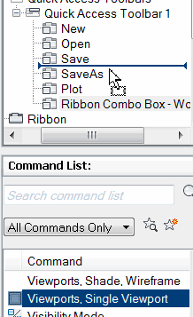

Before the Ribbon was introduced, when you wanted to create a new viewport, you could click the Single Viewport button on the Viewports toolbar, then just pick two corners for the viewport.
CUII find it curious, however, that there's no ‘Single Viewport’ item on the Ribbon [View tabViewports panel].
So let's put that one on the Quick Access Toolbar.
How to Add Single Viewport to the Quick Access Toolbar
  1. Enter CUI to open the Customize User Interface.
  2. Under Customizations in All Files, expand Quick Access Toolbars, then Quick Access Toolbar 1 to display the contents.
  3. Under the Command List, navigate to Viewports, Single Viewport.
  4. Drag the command up and release it in the list of commands on the QAT.
  5. Click OK to close the CUI and save the changes.
Quick Access ToolbarAnd there you have it!
