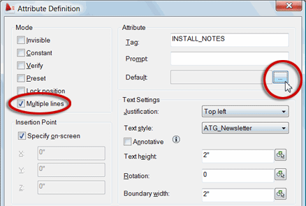

  2. To add an attribute, type ATTDEF to open the Attribute Definition dialog box. [Ribbon: Insert tabAttributes panelDefine Attributes]
  3. Specify a Tag value (no spaces), check the box for the Insertion Point, and specify your Text Settings.
  4. To create a multiline attribute, under Mode, check the box for Multiple Lines, then click the ellipsis at the right end of the Default field.

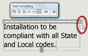

  5. When the multiline text editor opens, adjust the size to begin your entry, then enter the desired information. The right-click menu provides a few additional features.
  6. Multiline text editorClick OK to close the text editor and return to the Attribute Definition dialog box.
  7. Click Close and Save the changes to return to the drawing.

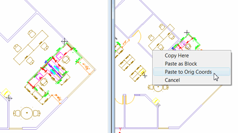

Paste To Original Coordinates

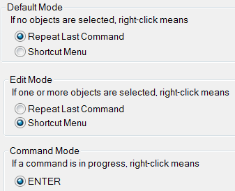

Mode selectionIf you have your Right-Click Customization setup appropriately, you can paste selected objects to their Original Coordinates.
Scenario: You're doing two or more proposals and the customer has finally made a decision (lengthy process as that may be, let's celebrate the small victories).
You used SaveAs to create the drawings you were developing, and now you need to copy the configuration out of the development drawing, into the Proposed (or AsBuilt) drawing.
Preparation: To setup your right-click so this works, go to OptionsUser Preferences, then click Right-Click Customization. Set the buttons as shown in the first figure.
Instructions to Paste to Original Coordinates
  1. Open each drawing - the one that has what you want to copy, and the target drawing to which the selection will be copied.
  2. Click WindowTile Vertically [Ribbon: ViewWindowsTile Vertically]
  3. Select the objects in the source drawing that you want to copy into the target drawing.
    Paste to Orig Coords
    Note: Before making your selection, you may want to Lock the layers which are not to be selected. Also, if the selection is comprised of less than 100 objects, you may see the grips.
  4. Now you're going to drag 'n' drop: Right-click on a highlighted line segment of the selected objects in the source drawing - but not on a grip - then drag the selection anywhere into the target drawing, and release the mouse button… and you will see a shortcut menu.
  5. Click Paste to Orig Coords and a copy of the selected objects will be placed in the target drawing in the same place they came from in the source drawing. (This presumes, of course, you didn't move the walls or other reference objects from the original drawing.)

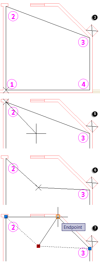

Adding a vertex to a polylineHeaven forbid you should ever need to add a vertex to an existing polyline; what a pig! To their credit, however, I think I saw somewhere that Autodesk is gathering input on how to make this process a bit more intuitive, because at this time… it ain't.
In this exercise, the polyline was created with four points, numbered in the order they were specified. The goal is to add a vertex between points 2 and 3.
Instructions to Insert a Vertex
  1. Launch the PEDIT command. [Alias = PE, Ribbon = Home tabModifyEdit Polyline]
  2. After selecting the polyline, you will see the following option string:
    Enter an option [Open/Join/Width/Edit vertex/Fit/Spline/Decurve/Ltype gen/Reverse/Undo]:
  3. Enter E for the Edit vertex option and you will see an "X" at what AutoCAD sees was the starting point of that polyline when it was initially created. (Shown as No. 1 in the figure) You now have the following option string:
    [Next/Previous/Break/Insert/Move/ Regen/Straighten/Tangent/Width/eXit] <N>:
    Note: When adding a vertex to an existing polyline, you want the "X" to be on the vertex before where you want to place the new one.
  4. In this circumstance, I'll press Enter to accept the default of Next, which will place the "X" at point No. 2.
  5. With the "X" at point No. 2, I now want the Insert option… and here's where it gets graphically interesting. You now have the prompt:
    Specify location for new vertex:
  6. The little rubberbanding line coming from the vertex is, admittedly, confusing. But all you need to do is just click anywhere to place the new vertex. Honest.
  7. At this point, you can cancel or eXit the command, then use grips to reposition the new vertex.

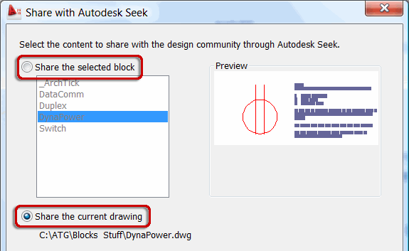

  1. Open the drawing with the content you would like to post to Autodesk Seek, then go to FileShare with Autodesk Seek.
    If you're using the Ribbon, click the Output tab, then Share with Autodesk Seek.
  2. If you have blocks within the drawing, click the button for Share the Selected Block, or go with the default of Share the Current Drawing.
    Share block or share drawing
  3. Click OK and you are taken to the Autodesk Seek Share web page. (If you modified the drawing, you may be prompted to Save the file or use the last saved version.)

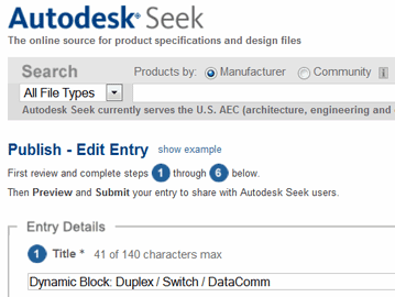

    In this exercise, I'm sharing DynaPower.dwg, a drawing containing a dynamic block my customers create in some of my training courses. It is also posted on the AutoCAD Stuff link at www.autocadtrainerguy.com.
  4. You will need to Login before you post your content, but it's quite painless.
    6 Steps
  5. Complete steps 1 through 6 which involves adding a description, categorizing, and including tags for easier sorting to assist in finding your content.
  6. SuccessClick Submit, then check the box regarding legal ownership of what you're posting.
