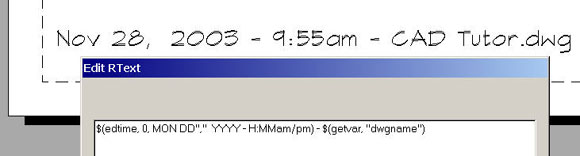

The Plot Stamp feature is fine, but one of my newsletter subscribers from VBH outside of Boston wrote in with a suggestion that perhaps the A2004 Express Tool Rtext would be more effective than a plot stamp:
"I have a line of Rtext with a Diesel expression in our Format sheets. Now when users Save, the file name updates in the title block (it works on Xrefs, too). The only drawback is that Rtext is left justified."
Launch Rtext, make the necessary settings for text Style, Height, and Rotation, then use the <Diesel> option to open the Edit Rtext dialog box.
To display the current Date, Time and File name in the drawing, put this in the Edit Rtext box:
$(edtime, 0, MON DD"," YYYY - H:MMam/pm) - $(getvar, "dwgname")
Spaces are recognized, but any additional characters within the parentheses need quotes. Edit the text with Rtedit. You may want to consider putting this in your template.
