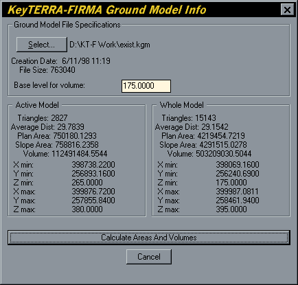

The Ground Model information command can be used to display all relevant information about a ground model file (.KGM). A ground model must be created before this command is used. The Ground Model Info dialogue box is shown below. As you can see, this command can be used to calculate the volume below any ground model.
The dialogue box is divided into three sections. The "Ground Model File Specifications" section gives information such as the full path name of the file, the date and time that the file was created and the file size. This section also contains an edit box which allows you to specify the base level for any volume calculation. By default, this value is set to the minimum Z value in the ground model. This ensures that the entire ground model will be used when generating areas and volumes. The sections below show what happens to the calculated volumes when this value is changed. Notice that it is not possible to generate a volume with a base level above the minimum Z value.
Base Elevation Variations
The Ground Model Info dialogue box also contains sections entitled "Active Model" and "Whole Model". The Active Model section shows information which relates to that part of the model which has been defined as "Active" using the Active/Passive Zones command. If no active/passive zones have been defined, the whole model is active and the contents of this section will be identical to that in the Whole Model section.

To calculate the volume below any ground model, simply start the Model Information command, select the ground model file, set the base level and click on the "Calculate Areas And Volumes" button. In a few seconds the results will be displayed in the Ground Model Info dialogue box.
In theory you could, in fact, do a cut and fill calculation based on the above method. Simply calculate the volume below any two ground models of the same extent (or with the same active/passive zones defined) and with the same base levels. Subtract the volume of the existing ground model from that of the proposed ground model. A negative result will give you the volume of cut, a positive value will give you the volume of fill. If both cut and fill are perfectly balanced, the result would be zero.
Although this method will give you a satisfactory cut/fill value, it is impossible to tell how the total is arrived at. For example, a gross figure of 10,000m³ fill might be arrived at by cutting 10,000m³ and then filling 20,000m³ or it may simply be arrived at by filling 10,000m³. Obviously the cost implications of the two possibilities are quite different. The Prismoidal Volumes command should be used where you need more information about a cut/fill calculation.

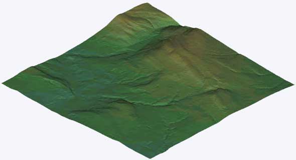

The Elevation Analysis command can be used to calculate the percentage area coverage of different elevation bands within any TERRA-FIRMA ground model. It can also be used to create a three dimensional triangular model of the terrain surface with triangles colour coded by layer for each elevation band specified. These triangles can either be 3D Faces or they can be Solids.
Elevation AnalysisThe image on the right was produced by rendering an elevation analysis created from 3D Faces. Six elevation bands were used and the band colours are the defaults set by TERRA-FIRMA. As you can see, this produces a clear visual analysis of ground model heights which works well in both 3D views and in plan. If you are working mainly in plan, it may be more efficient to create the triangles using Solids since they do not need to be rendered to give a solid colour effect. The image below shows the same analysis but this time the elevation band colours have been changed to make the distinction between bands more subtle and to more closely mimic real terrain colours. The highest band uses AutoCAD colour number 53, the others are coloured 63, 73, 83, 93 and 103 for the lowest. The change in colour was achieved simply by changing the layer colour of the various elevation bands with the Layers command, Layers from the Object Properties toolbar. The way AutoCAD colours display may vary depending upon your graphics card and monitor so it's always best to experiment with colours to get the best effect.
Rendered Elevation Analysis
In the example above, the elevation bands were set so that each colour represents a 50m elevation difference. The range in elevations within the model is approximately 100m to 400m. The red band represents elevations between 100m and 150m, the yellow band represents elevations between 150m and 200m and so on. You can use the Model Information command, Model information to find the elevation range within any ground model. The elevation range is expressed as Z min, the lowest and Z max, the highest. It's a good idea to do this before starting the Elevation Analysis command so that you can work out the number of bands you need and the range within each band.

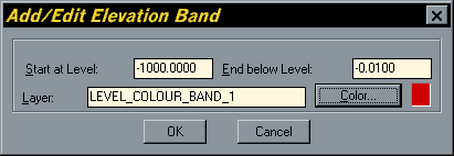

  3. When the Regions of different Elevations dialogue box appears, click on the "Add…" button. Add/Edit Elevation Band Dialogue Box
  4. Clicking the "Add…" button brings up the Add/Edit Elevation Band dialogue box, shown above. This dialogue box is used to specify the elevation range within each band and the colour that any 3D Faces or Solids that may be created.
    In order to correctly illustrate areas of cut and fill, we will need to define 3 elevation bands, one representing cut, one for fill and one where there is no change. The elevation range for cut will be from -1000 up to -0.01 , the range for "no change" will be from -0.01 to 0.01 and the range for fill will be from 0.01 to 1000. It does not matter that the maximum value in the fill band and the minimum value in the cut band exceed the actual ground model values. Part of the reason for going up to 1000 in each case is so that we can save this band set for use on future cut and fill analyses and there will not be many occasions (if any) where these values are exceeded. The figures for "no change" are notional, but reasonable in the context of such ground models. Effectively what we are saying is that any change between minus one centimetre and plus one centimetre is considered to be "no change".
    Regions of different Elevations Dialogue Box Enter the value -1000 in the "Start at Level" edit box and the value -0.01 in the "End Below Level" edit box. A new layer will automatically be created for each new elevation band. Use the Layer edit box if you wish to change the default name for this layer and click on the "Color…" button to change the default colour. Rremember, you can always change the layer colours at a later time since colours are assigned ByLayer. See the Layers section of the Object Properties tutorial to find out how to change layer names and colours. When you have finished defining the elevation band, click on the "OK" button. You will be returned to the Regions of Different elevations dialogue box and the first band will appear in the "Active set of Bands" list.
    Click on the "Add…" button a second time and define the second band (-0.01 to 0.01). Complete the band definitions by clicking "Add…" a third time and enter the values 0.01 and 1000. The Regions of different Elevations dialogue box should now look similar to the one in the illustration above. If you have made a mistake, you can always correct it by selecting the incorrect band from the list and clicking on the "Edit…" button.
