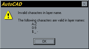

Error MessageThere are a few restrictions to consider when you are naming layers. The most annoying is that you cannot use spaces within layer names. So, for example, the layer name "Tree trunk" is illegal. However, it is common practice to replace the space with either a hyphen or an underscore, both of which are valid layer name characters. So, the layer names "Tree-trunk" and "Tree_trunk" are both acceptable. Some other special characters are also not allowed. If you do use an illegal character, AutoCAD will alert you with the error message box illustrated above. Notice that it very helpfully tells you which characters are legal. Basically, if you stick with letters and numbers you won't experience any problems. In addition to the hyphen and underscore mentioned above, the dollar sign is the only other symbol allowed.
Error MessageThe only other restriction relating to layer names is the number of characters used. Layer names can be between one and thirty-one characters long. This should give you plenty of scope to devise understandable and descriptive names for your layers. It is good drawing practice to name your layers sensibly, bear in mind that other people may have to work with drawings which you create. If you enter a layer name longer that 31 characters, AutoCAD will display the error message box shown on the left.

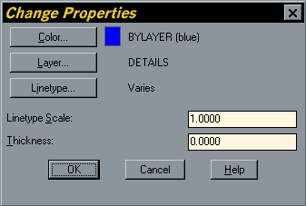

Change Properties Dialogue BoxAfter you have created the selection set the Change Properties dialogue box appears. To change the layer of the selected objects, pick the "Layer…" button and you will see the Select Layer dialogue box which lists all the layers in the drawing. Simply pick the name of the layer you want and then pick "OK". On returning to the Change Properties dialogue box, you can either change other properties or return to the drawing by clicking the "OK" button. The selected objects are now on the chosen layer. If the new layer has a different colour, the objects will be redrawn in this colour. If the chosen layer is turned off or frozen, the entities will become invisible.
Changing the colour and linetype of a number of selected objects is very similar. Use the "Color…" and "Linetype…" buttons to invoke the Select Color and Select Linetype dialogue boxes from which you can make your choice of Colour and Linetype respectively. Notice in the dialogue box above that the current linetype is displayed as "Varies", this is because a number of objects have been selected with different linetypes. However, all the objects are on a layer called "Details", so the layer name appears against the "Layer…" button. Linetype scale and Thickness are set by entering a numeric value in the appropriate edit box. The "Thickness" option allows you to give an object a thickness in the Z direction. You can, for example create a cylinder by giving a circle thickness. Thickness should not be confused with Width. Width refers to a property of polylines which can be used to cause the polyline to display as a wide solid line. See the "Basic 3D" tutorial for more information on using object thickness.
Beware of using the Properties command to change the colour and linetype of drawing objects because this will override the settings that you have made in the Layer & Linetype Properties dialogue box. Once a colour or linetype property is changed using this command, any changes to the objects colour or linetype using layer settings will have no effect. To enable an objects colour and linetype to be controlled by layer, the object colour and linetype must be set to "ByLayer".

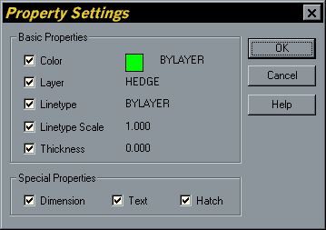

Property Settings Dialogue BoxOnce the command sequence has been completed, the destination objects will inherit all of the current active settings which are specific to that object type. You can control which properties are matched and which are not by using the "Settings" command line option. The Settings option displays the Propert Settings dialogue box, shown on the right. By default all property settings are active (checked). You can deselect whichever properties you don't want to match simply by unckeching the box against that option. The property settings are maintained until the end of the current AutoCAD session or until you change them.
