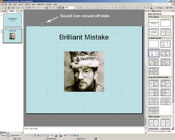

Sound IconYou will see a small icon appear in the center of the slide. This icon represents the sound file. Deleting the icon removes the track from the presentation. You can move the icon to another part of the slide if you need to see it during the slide show or you can move it off the slide if you want to hide it during the show. Just click and drag to move it.
Sound icon off slide
There is another way to hide sound icons which we will come to later but moving the icon off slide is probably the simplest method.

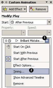

You can control when and how animation events occur using the Custom Animation panel. To display this panel, select Slide ShowCustom Animation… from the pull-down menu or right-click on the sound icon and select Custom Animation… Either way, the panel on the right of the screen changes to show a list of all animated objects on the slide. Since a sound file is, by its very nature, an animated object, it shows up in the list and is identified by the file name.
When (trigger)
Effectively, there are three possible triggers for any animation effect, including the playing of audio tracks. These are, On Click, With Previous and After Previous. If the start trigger is set to "On Click", the track will begin to play when the mouse button is pressed. If the start trigger is set to "With Previous", the track will begin to play at the same time as the previous animation event. Using this trigger, it is possible to have the track play while some other object or objects are moving on the slide. If the start trigger is set to "After Previous", the track will begin to play after the previous animation event has finished. However, this trigger has an additional parameter that allows you to set a delay time in half second increments. This means that, for example, you could have the track play 4.5 seconds after the previous event has finished.
When you insert a sound file, the trigger is set to On Click if you choose not to start the track automatically and it is set to After Previous with a delay of 0 seconds if you choose to start it automatically. The current start trigger is displayed at the top of the Custom Animation panel in the "Start" drop-down list. It can be changed by clicking the down arrow and selecting a different option from the list.

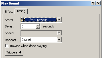

Play Sound Dialogue BoxIf the start trigger is set to After Previous, you can set the delay time by clicking the down arrow next to the filename in the animation list and selecting Timing… from the menu (see illustration above). This displays the Timing tab of the Play Sound dialogue box, shown on the left.
Use the Delay option to set the number of seconds that the audio track will wait, after the previous event has ended, before playing commences.
The other useful option to look at here is Repeat. You can use this to control the number of times a sound is repeated. This may not be particularly useful for lengthy audio tracks but it can be useful when working with short sound effects.
