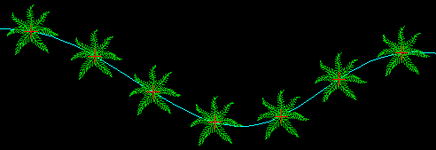

Keyboard | NODE (when picking) |
The Node Osnap snaps to the center of a Point object. This osnap can be useful if you have created a number of Points with the Measure or Divide commands. You could, for example insert a number of regularly spaced tree symbols (blocks) along a line by using the Node Osnap for the insertion point of each block.
The image above shows a Spline (cyan). The Measure command has been used to set Points (red) at regular intervals and a tree symbol has been inserted with the Insert command at each Point location using the Node Osnap.

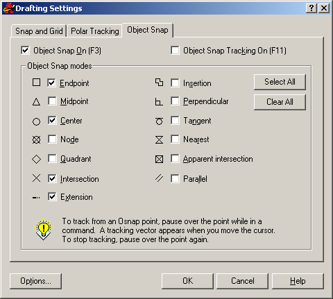

Using the Object Snaps as described above can sometimes be a consuming process. Every time you want to snap to an endpoint, you need to click on the Snap to Endpoint button. If you have a lot of endpoints to snap to, this can become a little tedious. For example, when we used the Node Osnap to insert lots of tree symbols, above, the Snap to Node button had to be clicked each time an insert point was picked. Wouldn't it be great if there was a way to have osnaps running in the background so that you could snap without having to invoke the snap tools explicitly? Well, the good news is that AutoCAD provides just such a facility and it is called Running Object Snaps.
You may already have been using running object snaps without noticing it. When you first start AutoCAD, a number of running object snaps are set by default. If you hover the cursor over an endpoint while being prompted to specify a point, you may see the square osnap marker spontaneously appear. If so, you have running object snaps set on.
Running object snaps can be configured using the Object Snap tab of the Drafting Settings dialogue box, illustrated below. This tabbed dialogue box and also includes settings for Snap and Grid and for Polar Tracking.
The Drafting Settings dialogue box can be used to set one or more osnaps so that you don't need to keep invoking them as you draw. For example, if your drawing requires the use of a number of Center and Endpoint snaps, use the Drafting Settings dialogue box to set these two osnaps on by checking the box next to their respective names. Try setting some running osnaps now. From the pull-down menu select and when the dialogue box appears, click on the Object Snap tab to display the Object Snap settings. Check the boxes against the Center and Endpoint osnaps if they are not already selected. Now, make sure that the "Object Snap On (F3)" box is checked as in the illustration on the right. Click the "OK" button to confirm your settings.
The selected osnaps will remain running until you turn them off by deselecting them in the Osnap Settings dialogue box. However, sometimes you may simply want to suspend the running osnaps temporarily. To do this, click the OSNAP button on the status bar at the bottom of the screen or use the F3 key on the keyboard. This button acts as a toggle, so you just need to click it again to set running object snaps back on. Try this now and notice that the OSNAP button appears "pushed in" when toggled on and "popped out" when toggled off. This visual clue is useful because you can see at a glance whether your object snaps are running or not.
Incidentally, you can also use the OSNAP button to launch the Drafting Settings dialogue box. Right-click on the button and select "settings…" from the context menu.

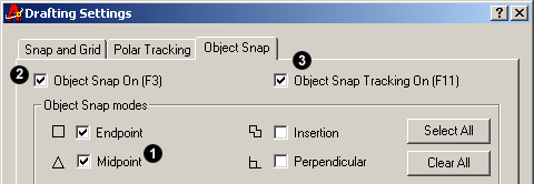

Object snap tracking is to temporary tracking points what running object snap is to object snaps. Essentially, it enables you to have tracking running in the background so that you need not use temporary tracking points. However, for object snap tracking to work, running object snaps must also be defined and turned on.
You control the use of object snap tracking with the OTRACK button on the status bar or with the F11 key. Just like the other mode buttons on the status bar, the OTRACK button acts as a toggle, switching object snap tracking on and off as required.
In order to demonstrate how useful object snap tracking and running object snaps are in combination, let's try the rectangle and circle example again. First, we must ensure that the midpoint object snap is set as a running object snap and that running object snaps are turned on. We must also turn object snap tracking on.
You can check all three things at the same time, using the Drafting Settings dialogue box. Right-click on the OTRACK button and choose "Settings…" from the context menu. Make sure that the options set in your dialogue box are the same as those shown in the illustration above.
