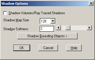

The nine images above show the effects of varying shadow map size and softness. The center image is the result of the default values, as shown in the dialogue box on the right. As you can see, the results vary from the almost realistic to the surreal. To make shadow map settings you must first have created at least one light. Then, start the Light command from the pull-down menu, select the light name from the list and then click the button. Then, in the Modify dialogue box, click the button. When the Shadow Volumes/Ray Traced Shadows check box is deselected, you will be able to set the two shadow map variables.
