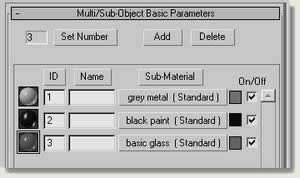

- Press Set Number and alter to 3
- Press the first Sub Material button with ID 1 to access the first sub material. Notice that this is just another standard material with all the parameters found when starting a material from scratch. Rename the sub-material grey metal
- Create a mid grey material with Specular level 90 and Glossiness 70. This give a good grey metal paint
- Press Go to Parent to go back to the Multi/Sub-Object Basic Parameters and press the next Sub Material button with ID 2
- Call this material black paint and create a black paint effect using the Anisotropic shader parameters
- Press Go to Parent again to go back to the Multi/Sub-Object Basic Parameters and press the third Sub Material button with ID 3
- Call this material basic glass and create a transparent glass effect using the Anisotropic shader parameters thus:
- On the Anisotropic shader parameters change the Diffuse colour to light grey, Specular Level to 120, Glossiness to 80 and Opacity to 40.This gives a basic glass effect that, although doesn't reflect and refract light is adequate for the purpose. Use the chequered background in the sample window to view the results and double click on the sample window to show a larger window if required
- Press Go to Parent again to go back to the Multi/Sub-Object Basic Parameters. The material top level should look like the image below

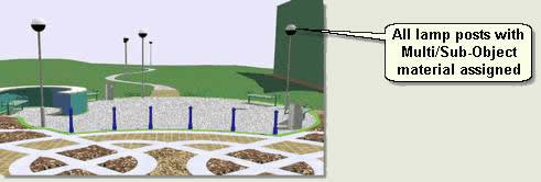

- With the lamp post still selected Assign Material to Selection. Notice that the lamp post elements pick-up the various sub-materials contained in the Multi/Sub-Object material
NOTE: No UVW Map modifier is applied here because the material uses the basic parameters and no maps
- Exit Isolate Selection and select all the lamp posts before assigning the material to them all

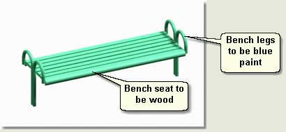

- Select Bench 01 and Isolate Selection
- Alter the Material IDs of the legs and seat as above, giving the legs a Material ID of 1 and the seat slats a Material ID of 2

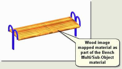

- Create a Multi/Sub-Object material called Bench with a standard none-mapped blue paint material for sub-material ID 1 and a wood material using CEDFENCE.jpg as the mapped image
- Assign Material to Selection and apply a UVW Map modifier to the bench. You will need to adjust the UVW Map modifier parameters to position the wood image map correctly on the bench seating
NOTE: Because there is only one map present in the Multi/Sub-Object material you can apply a UVW Map modifier to the whole object and it will effect the one map. When you assign a Multi/Sub-Object material that has multiple sub-materials containing maps, the UVW map modifier has to be applied to each element. Otherwise the modifier changes all maps on the object globally. Later, 'The Mapped Cube' explains how to adjust mapping on separate parts of an object when more than one map exists in a multi/sub-object material
UVW Map modifier Parameters. Change the Mapping to Box and Length, Width and Height to 1. Change the V Tile to 0.3
Rotate the Gizmo 90 degrees on the Z axis. This gives a convincing wood effect for the seating

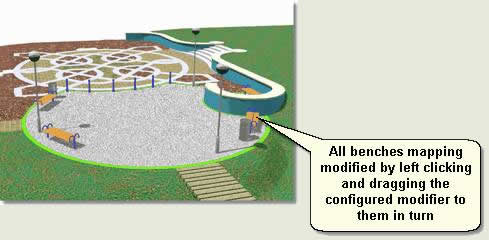

- Exit Isolate Selection and select all the benches
- Isolate Selection and assign the bench material to all the benches
- Select Bench 01
- In the Modify Panel left click and drag the UVW Map modifier onto the other benches in the viewport in turn. This instances the modifier to each bench and means you do not have to go through the process of adjusting the UVW Map modifier parameters for each bench. Now, if you want to tweek the mapping on one, the mapping on each bench will be updated

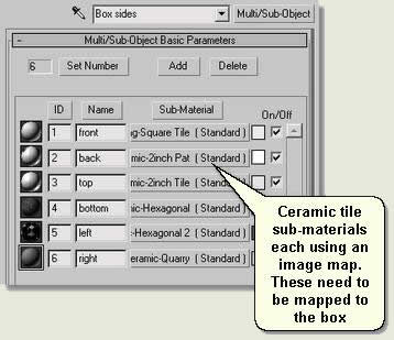

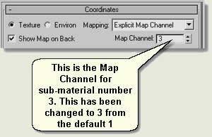

1. Create Multi/Sub-Object material and configure Map Channels
- Open the Material Editor and select Box sides material. This has already been created for this tutorial using ceramic tile sub-materials. Each sub-material uses an image map and so needs to be mapped correctly on the object separately. Notice also that the sub-materials have been named at the top level to keep track of exactly what part of the object the sub-material pertains to
Open the parameters for each sub-material in turn and at the map level notice that the Map Channel number has been changed to correspond to the sub-material number
TIP: The Map Channel number does not have to correspond to the sub-material number (just the Map Channel number in the UVW Map modifier parameters). However, keeping these numbers consistent is a good idea

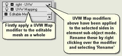

2. Apply a UVW Map modifier to the editable mesh, and then to independent polygon sub-objects
- Assign the Box sides material to the box
Notice in the modifier stack that a number of UVW Map modifiers have been applied to the box. A UVW Map modifier has been firstly applied to the whole object. Then, in element sub-object mode each side (polygon) has had a UVW Map modifier applied. After each application of the UVW Map modifier to each polygon the user has right clicked on the modifier in the stack and renamed the modifier so that they can keep track of exactly which part of the object the modifier is affecting

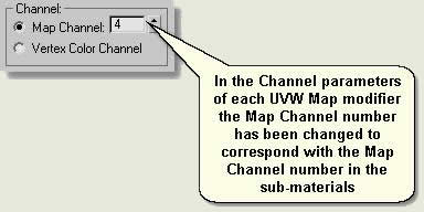

3. Configure each polygon sub-object UVW Map modifier to work with independent Map Channels
- In the Modify Panel select each of the UVW map modifiers pertaining to different sides of the box. Notice that under Parameters rollout > Channel the number has been changed from the default '1' to correspond with the Map Channel numbers in the sub materials pertaining to the sides (Step 1). The sub-material numbers have also been made to correspond for consistency (although this is not strictly necessary)

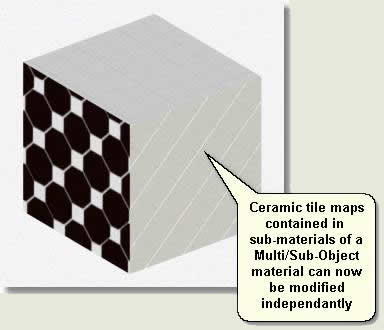

4. Modify each sub-material independently
- Select Box 01 and in the modifier stack select front - UVW. Change parameters such as the tiling and select the gizmo and move and rotate the map on the side of the box. This is now done independently
