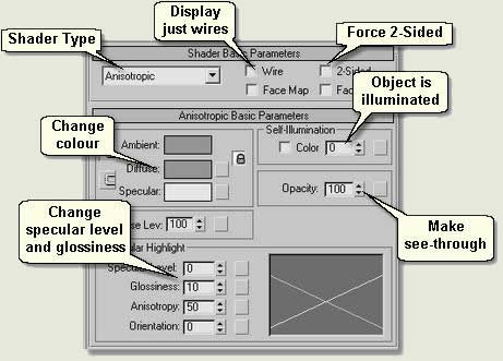

Shader Basic Parameters rollout
These settings apply to any shader
- Check Wire and toggle this on and off to display the sphere in wireframe. If you change the amount of segments in the sphere the wires change as well. Uncheck this before proceeding
- Checking 2-Sided forces the material to become 2-sided. This is the third (apart fronm the Viewport Configuration and Render Scene dialogs) place you can make an object 2-sided

Anisotropic Basic Parameters rollout
- Click the colour swatch to the right of Diffuse to change the colour of the sphere
NOTE: The Ambient swatch changes as well as the Diffuse swatch. This can be unlocked by pressing the lock button to the left of the Diffuse and Ambient swatches. The Ambient light can then be changed independantly
- Change the Specular Level to 75 and Glossiness to 50. This gives the material a look of gloss paint or plastic. You could name this 'Blue Paint' for example and save the material for use in many scenes (explained later)
- Change the Diffuse colour to light yellow and the Self-illumination to 80. This simulates a lamp and will show as illuminated in a night scene. A light would be placed in the lamp. Change back to 0 before proceeding
- Change Opacity to 40. This makes the sphere translucent. Used in conjunction with the other settings (especially Specular Level and Glossiness) a simple glass material can be created. Look at the settings in the Glass material for reference

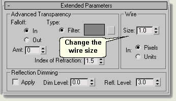

Extended Parameters rollout
- With Wire selected in Basic Shader Parameters change the size of the wire on this rollout

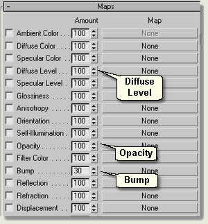

Maps rollout
This is where various maps can be applied to the material. In landscape work the most used maps are applied to the Diffuse Level (all landscape materials) plus perhaps Opacity (for masking buildings, signs, vegetation etc images) and > or Bump (for giving relief to walls and paving)
- Press the Map Button showing 'None' to the right of any of these Map types to open the Material/Map Browser. For now, just have a look at the types of maps available
