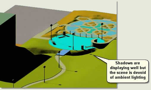

Sunlight settings
- Shadow Parameters rollout > Click the colour swatch next to Color and change the colour to very dark grey instead of black
- Change the Density to 0.8
- Shadow Map Parameters rollout > Bias - Set to 0 - this changes how far the base of a shadow is from the object
- Density - keep on 1
- Size - Set to 3000 - this is the size of pixels of the shadow 'map' (or image) used for the shadows. On a large site the size should go up accordingly (not above about 5000) and a smaller site down to 512. Decreasing the Map Size and increasing the Sample Range and / or Fall Off (Directional parameters rollout) will make shadows less sharp:
- Sample Range - Keep at 4. However, to make shadows sharper decrease the amout to 2 or 3. To make them less sharp increase to 5 or 6
- 2-Sided Shadows - uncheck
Top of page

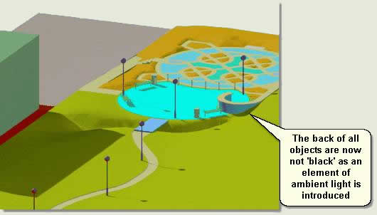

Provide ambient lighting
If just a Sunlight System is used (ie one light), then the sides of objects that are not in sunlight will appear very dark or black and shaded areas will appear too dark next to lighter areas. This is a totally unnatural situation. In the real world light is reflected from surface to surface giving shaded areas an element of light and more subtle shade. This type of lighting is called 'ambient' light. To recreate ambient light in a scene a Skylight light object can be used with the shadow settings turned off and further tweeks made through the Environment dialog settings
NOTE: In MAX rendering with light tracing is often used to give very good global illumination (not covered in Key Fundamentals)

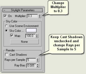

- Create Panel > Lights > Skylight > In the Top viewport left click at the centre of the scene to position a Skylight object
- Change the Multiplier to 0.3 and Rays per Sample to 5 (this reduces rendering time)
- Finally, visit the Environment dialog settings to further configure ambient light level and colour

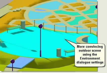

Environment Dialog settings
- Render > Environment dialog > Background. Change the background colour to light blue by clicking the colour swatch
- Global lighting > Set the Level spinner to 1.1. This further adds to the ambient lighting effect
- Ambient Light > set the colour to mid grey

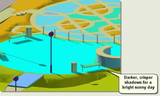

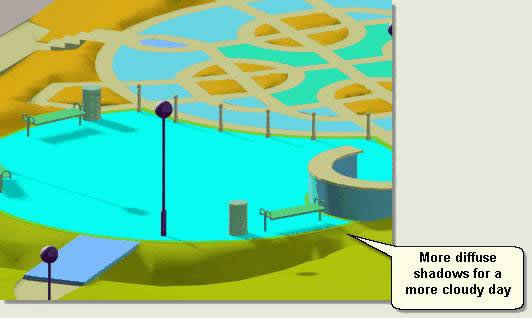

Fine-tune shadow settings
On the Sunlight parameters:
- Colour: darker > Density: 1 > Size 4000 > Sample Range: 2
- Colour: lighter > Density: 0.8 > Size: 1000 > Sample Range: 6
