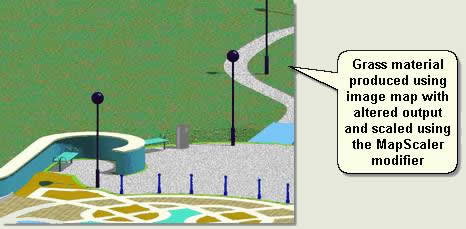

Meadow
- In the Material Editor select the next available sample window
- Name the material Grass
- Choose the Anisotropic shader
- Click the Map button to the right of the diffuse colour swatch to drop to the map level. This opens the Material/Map Browser so you can choose the type of map you need for the job
- Double click Bitmap. Navigate to the tutorials Maps folder and select Grass 11.jpg. This is an image of grass that has been optimised for tiling making it appear seamless when repeated over a large area. Press Open
- Press Go to Parent button and Show Map in Viewport button then select Meadow and Assign Material to Selection
- In the Material Editor map coordinates parameters make sure Real-World Scale is checked Off and Size is 0.1,0.1
- Test render and notice that the grass is rather light in colour and is not scaled correctly (the pixels are too large)
- Apply a MapScaler modifier. Change the Scale to 3 and test render. The grass looks better scaled
- To cahnge the brightness and colour of the grass: In The Material Editor press the Map button to the right of the diffuse colour swatch to go to the image Map level
- Output rollout > Change the RGB Level to 0.7. This will show the map going darker in the sample window and will render darker. You may also want to adjust the colour of the grass if needed using the Enable Color Map checkbox with RGB selected. Select R or G or B and move the right hand nodes up or down

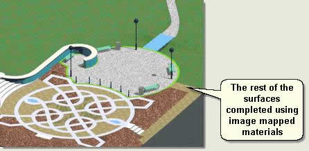

Planting Beds, Car Park, Maze surfaces and Pavement
- Repeat the above routine. However for:
- Maze mosaic use Aggregate 01b
- Pavement just assign the Flags-red-bricksmap material
- Building path just assign the Flags-red-bricksmap material

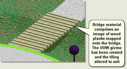

Bridge
- Finally use Wood-06b for the bridge material
- Rotate the UVW Map gizmo 90 degrees on the Z axis and change the V tiling to 1.7
