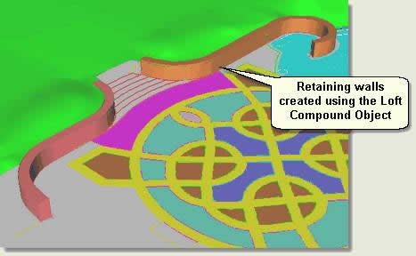

Retaining Walls
  • Either start from the previous stage or open kf303_01.max
  • Select Wall.01 and Wall.02. These are closed polygons created in AutoCAD to delineate the retaining walls in plan view
  • Isolate Selection

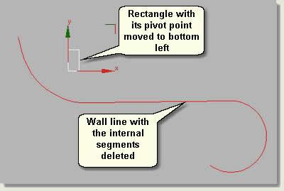

  • In segment sub object mode delete the inner (towards the meadow) and end segments to leave a wall line to serve as a loft path
  • Draw a rectangle 0.5m wide and 1m high to serve as a loft shape
  • Move the pivot point of the rectangle to the bottom left. This is the point at which the shape will be lofted
  • Select the wall line and create a loft using the rectangle
  • Notice that the loft is created on the wrong side of the line. To rectify this and whilst still in the loft command, press down the Ctrl key on the keypad and select the rectangle again. This switches the loft to the other side of the line
  • Under the Skin Parameters rollout change the shape steps to 0 and the path steps to 7
  • Repeat the lofting process using the same rectangle shape for Wall.02. The loft parameters should stay the same and the creation of this retaining wall loft should be a one click process

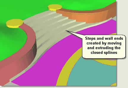

Steps
  • Select Steps top.06. Using Transform Type-In move to 0.9m above 0
  • Select Steps top.05. Move to 0.75m above 0
  • Select Steps top.04. Move to 0.6m above 0
  • Select Steps top.03. Move to 0.45m above 0
  • Select Steps top.02. Move to 0.3m above 0
  • Select Steps top.01. Move to 0.15m above 0
  • Select all step splines and apply an Extrude modifier to a value of -0.2
  • Select Wall ends.01 and Wall ends.02 in turn
  • Move the wall end splines to 0.9m above 0 and extrude to 0.15m

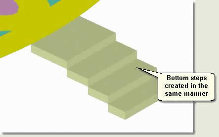

  • Repeat the process with the bottom steps, this time moving the step splines down in 0.15 intervals, then extruding to -0.2

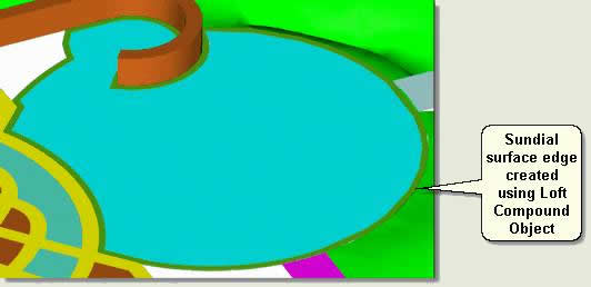

Sundial Surface Edge
  • Select Sundial boundary. This will serve as the path for a Loft Compound Object
  • Draw a rectangle 0.2m wide and 0.05m long
  • Create the sundial surface edge using the sundial surface path as the loft path and the rectangle as the shape, using the Skin Parameters to optimise the loft
