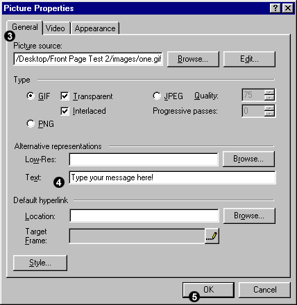

To add a text alternative to an image, follow the steps below:
  1. Click on the image in Normal view to highlight it.
  2. Right-click on the image and select Picture Properties… from the menu. You may also use FormatProperties… from the pull-down menu or the keyboard shortcut Alt+Enter. Whichever method you choose, you will be presented with the Picture Properties dialogue box.
  3. Click the General tab on the dialogue box if it is not already selected.
  4. Type the message that you want associated with the image in the Text box under Alternative representations.Picture Properties Dialogue Box
  5. Click the OK button to complete the process.
  6. Once you have added a text alternative you should test it to make sure it works. Click on the Preview tab and move your mouse pointer over the image. Keep the pointer still for a few seconds. Your message should appear at the cursor position.
  7. Click the Normal tab to move back to Normal view.
